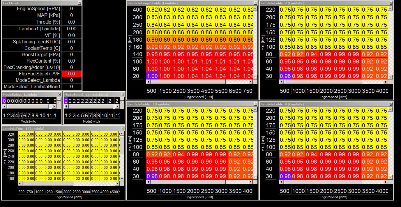

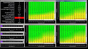

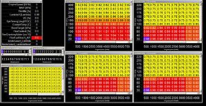

I am not sure why you keep bumping, I sent you a very direct answer to your question. Yes you can do all the stuff you are asking about. You will need a trim pot.
Attached Thumbnails Question for anybody who has aem ems!!!!-boost.jpg   Question for anybody who has aem ems!!!!-ignition.jpg   Question for anybody who has aem ems!!!!-lambda.jpg
