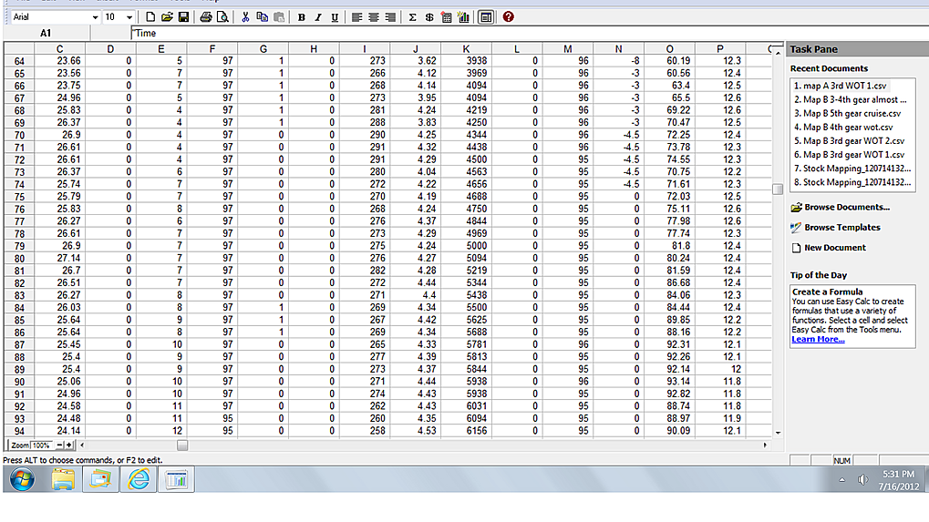

I'm logging a Zeitronix WB in ATR without issue. Took a while to figure it out but I found that when my ZT3 is plugged into Comm port 4 on my XP computer (confirmed by system properties) I have to enable com port 3 in ATR. No idea why but it works great now. Here is a screen shot just to irritate you even more (row P)
