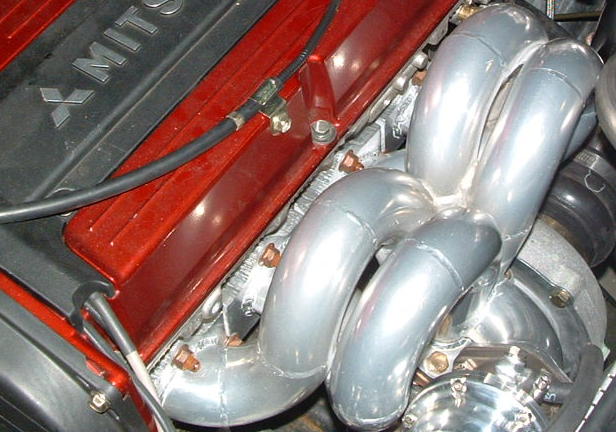

some pics

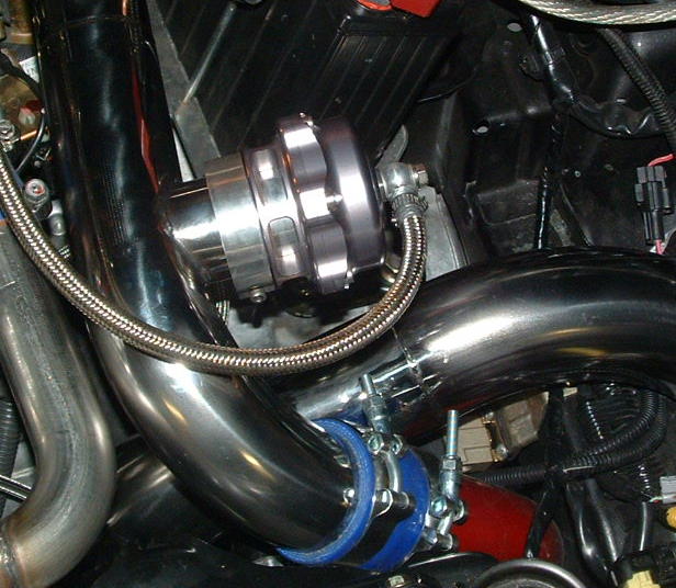

pics

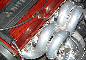

another

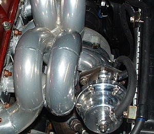

more

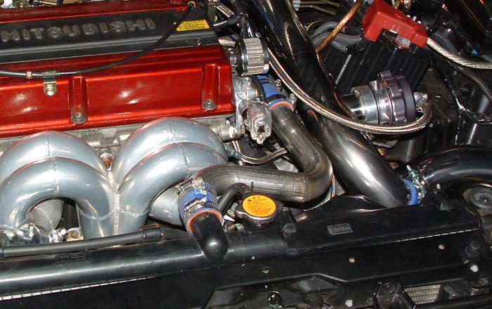

one more
