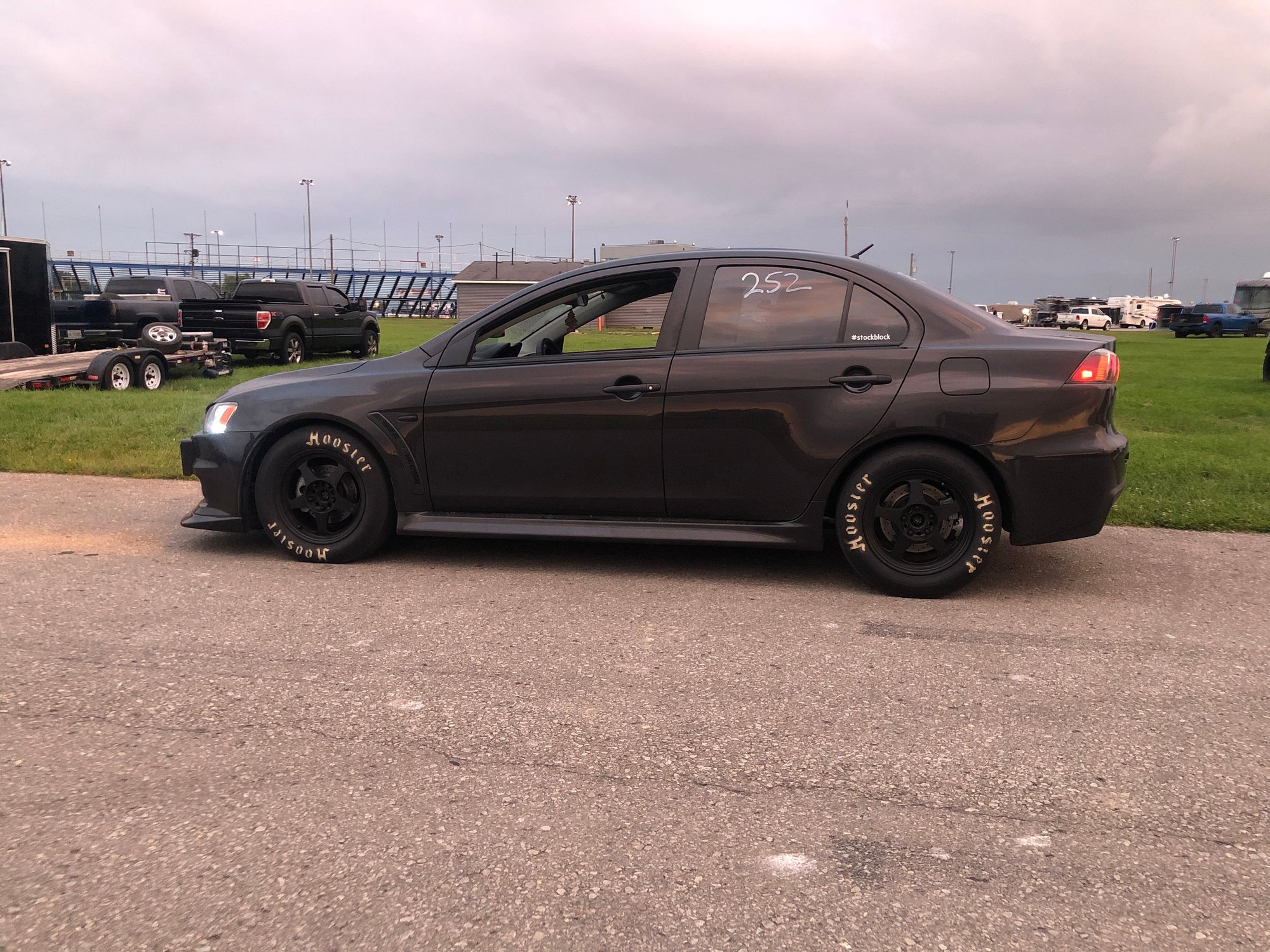

My goal is to get this stock block X into the 10's or as close as possible. But the launches/60' have been kicking my butt, and I am not afraid to admit I need work.
Car traps 126mph, so it makes some power for a stock 4B11. Weighs roughly 3350-3400 with me in it. It's on a T4 6266. Stock X 5 speed trans (stock final drive) with the shep diff pins, and repacked Evo 8 rear diff / Ralliart CV shafts. For a clutch, It's an ACT 6 puck, Evo 8 clutch master & clutch pill removed. The car is on Hoosier QTP's, 26x9.5x16. Launch control is set to 5750rpm.

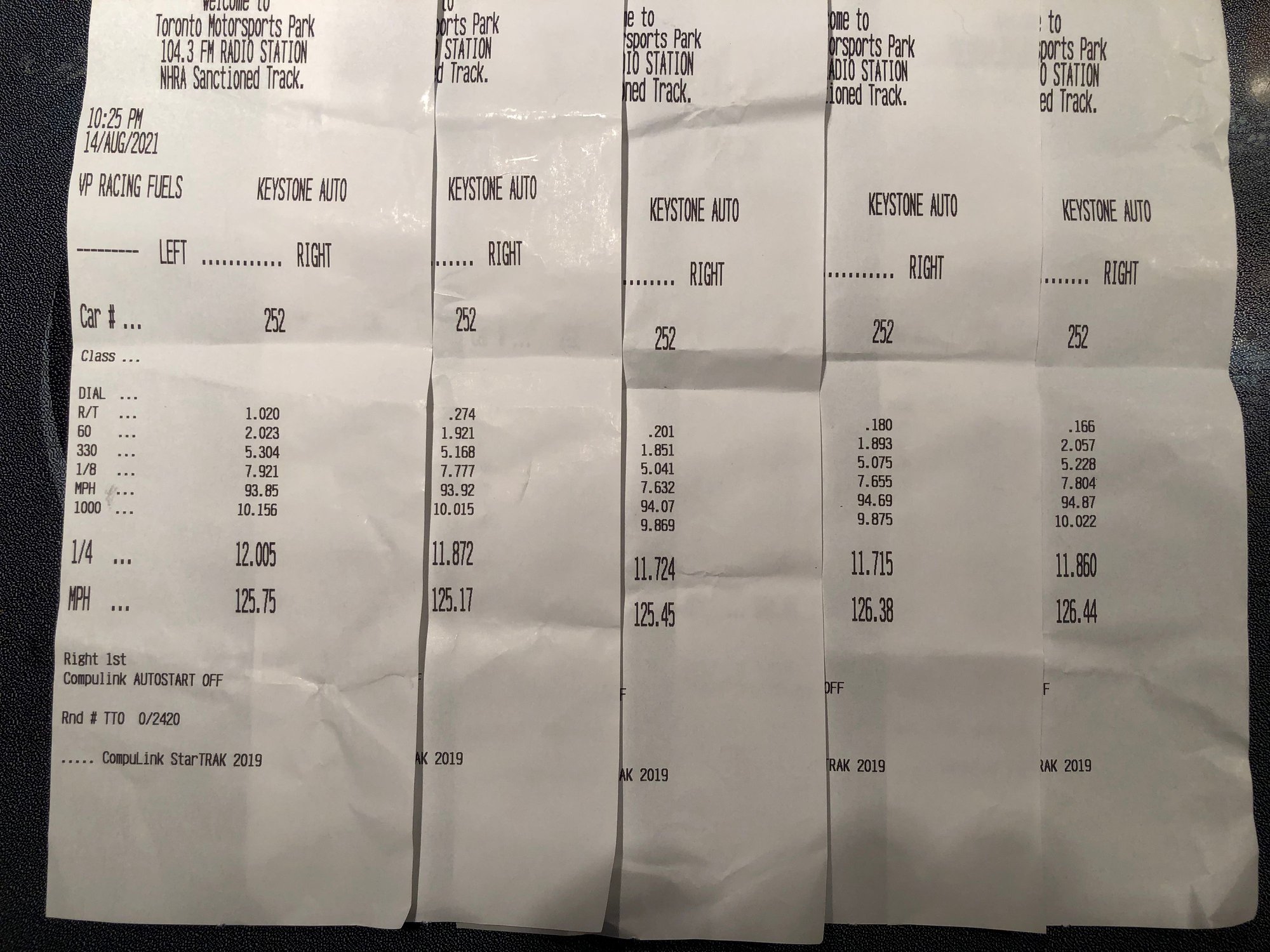

Launches for me either consist of bogging, spinning, or a weird combination of none but still not fast enough to cut a good 60'. I am struggling, best its been has been a 1.7, most are complete crap 1.8-2.0's (I know, I know, I've had FWD cars on all seasons cut better times LOL)
I think my tire pressure was a bit high, 20-21psi in the QTP's. Most people I've talked to so far are down to 14-16psi. Maybe that's part of the problem (when I spin anyways) I still need to see how much boost it builds, maybe I need to sit on the 2 step a second longer. Maybe I need to practice the hand brake launch more and get that down better. Maybe my 1-2 shift is killing my times as well, since I can only rev it out to 8200 it takes a split second to come back into boost. Maybe I need NLTS? I know that's past the 60' mark, but still early enough to play a role in ET compared to say then 3-4 shift. I definitely need more seat time.
Any input/tips/tricks would be great. The best I've gotten was on the FP Black, where (again with a poor launch) I ran an 11.6 @120. I did the same on the 6266, but after a couple tweaks the car has been able to trap 125-126 consistently, but my times have gotten worse.
