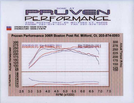

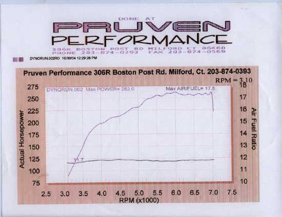

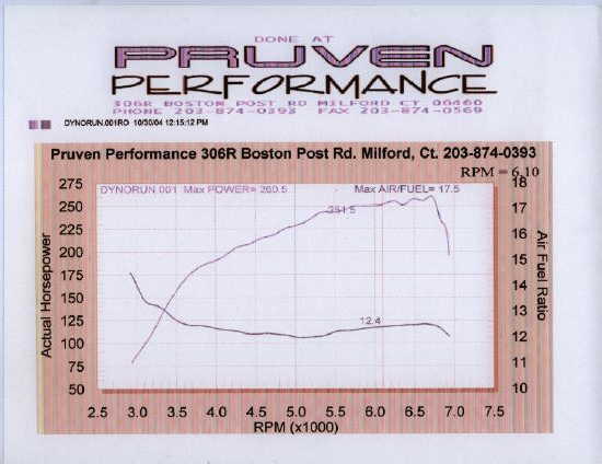

This case is a perfect example of why you should NEVER change intakes on a car which was reflashed for a stock intake
Reflashes generally make power by leaning out the a/f ratio
When you add a aftermarket intake - such as in this case the HKS RS KIT - it has the effect of distorting the mass air flow reading and makes the car run very lean in the middle of the power band
Here this gentlman's mods were the following :
Works P1 Flash
HKS RS Intake
3" down pipe
Cat back exhuast
NOTE - Stock cat and fuel pump
Boost 21 psi peak taper to 19 at red line
Nothing wrong with Works flashes - JUST never add a aftermaket intake on to a flash dset up for the stock air box - be it my flash or any other flash. It is best to consult with your flash designer before doing mods. In this case the air filter swap resulted in low whp and a dangerously lean a/f curve

Here is our first stab with a base line Dyno Flash
We actually don't have that many good maps for this intake with the stock fuel pump and cat anymore as 99% of my customers get the upgraded walbro pump - which I highly recomend
Here he is running a bit lean

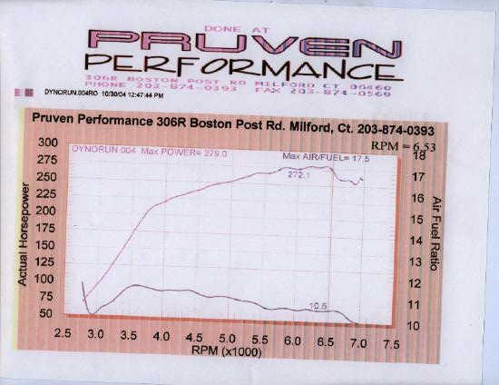

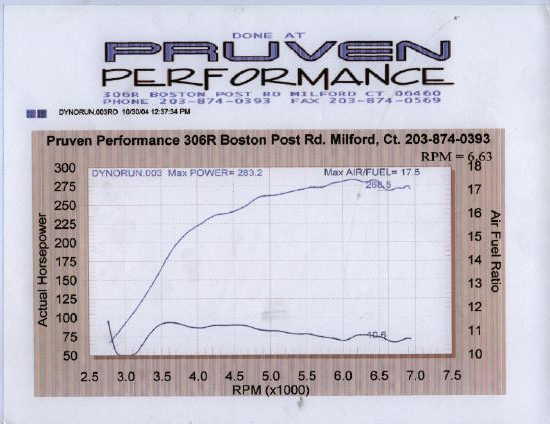

After 12 total dyno pulls and having made as much as 287 whp - which is the rannge we would expect with the stock cat in place, we realized that the car was having some significant knock issues. The customer visited a suspect Exxon station in NYC for his fill up. Looking at how the car was responding during the two hour tuning session it seemed to me that he did not get a tank of genuine 93 octane
In order to get the car to run smoothly we had to de-tune the car to actually slightly below our 91 octane california ign timing settings
I suspect bad gas and we have invited the customer to return with a new tank of fuel for further test and tune
In the meantime - we were able to get him nice power and trq gains over what he rolled in with WHILE at the same time making the a/f much richer and safer
We will revisit this customer on another day as we usually expect about 15 - 18 more whp with this combination on the stock cat
As an aisde - the fuel pump was not an issue as he had plenty of fuel supply for this power level
When tuning, it is important to listen to the motor and see how it is reacting and selct the appropraite and safe seetings
I am not interested in cars which are one hit wonders making huge dyno numbers and then later pulling timing or exploding. Saftey and smoothness are my # 1 goals.
