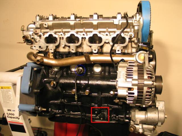

I bought all the parts and attached the knock sensor to the head just to make sure it all worked. Tapped around and saw all the LEDs light up. The issue i am having now is that the only bolt size that I can use to mount the knock sensor (donut type, two prung GM knock sensor) is a 12 mm socket size bolt. All the threaded openings in the back of the block are for 14mm socket size bolts. Anyone else run into this issue? If so, where did you end up mounting the knock sensor?
Need to get this working so I can buy my alky kit from Al....... Thanks in advance guys....
There are bungs in the block which can accomidate the smaler bolt
Al, can you be more specific? The only smaller threaded size holes I noticed were by the bottom right of the block, but it looks like it may not fit because of the axle.

Originally Posted by DrEvo
Al, can you be more specific? The only smaller threaded size holes I noticed were by the bottom right of the block, but the axle would get in the way.
but the axle would get in the way - WHY would the axel get in the way? It works fine on my car
I was able to find a picture online from "Joeycoates" engine build. I went ahead and circled the stock knock sensor blue and the red square area is where I was thinking to mount the GM knock sensor. Is this the area you are referring to?
Thanks Al.
I just posted up with a pic, i might be talking about a different location than the one you are referring to. Thanks again.
Thanks Al.
I use a bosch knock sensor and it fits there fine !
Thanks alot Al, I'll go ahead and use that spot ..... I'll be giving you a call soon about the alky kit + tune
