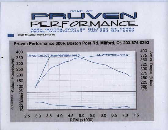

Here is the first Alcohol tuned evo with the Dyno Flash - man this is better than nos - (and a lot safer)
Aem Intake, 3" Buschur Turbo Back exhaust, Walbro fuel pump, 264/264 cams
Custom Dyno Flash
Buschur Alcohol injection kit with denatured alcohol
25 psi boost
This car was the most fun to drive evo I have ever driven - it breaks loose the rear in in 1st and 2nd - the power band was very broad
As I predicted the Alcohol is a big winner making MUCH more power than we could even make with C-16 race fuel - I suspect due to the intercooling nature of the alcohol injection

Those are awesome numbers. Is this with the stock turbo and stock FMIC?

wow those are some nice numbers..
Stock turbo, stock intercooler, stock intercooler piping.
