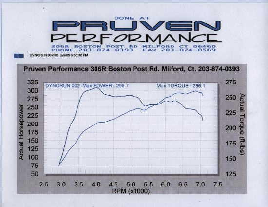

Here are his mods on a sweet 05 MR
HKS RS Intake w/ Apexi filter
3" Exhuast with TX dp, cat delete and HKS cat back
Vishnu cam gears set to vishnu specs
RMR fmic pipe kit
Exed unit with some 93 stage one map that the customer down loaded - HE HAD NO PROPER BASE MAP FOR HIS MODS SO HIS MAP WAS WRONG and there was NO MAP available for his set up so he was apparently in a bit of a bind
Here is the base line dyno sheet with pump gas
NOTE* This thread is NOT intended as a flame of any other product or any comparison to any other tuning solutions as the other product was untuned.

seems like pretty good numbers.
I dyno'd my MR with just TBE and boost controller and got 265whp so I say his MR is on the stronger side

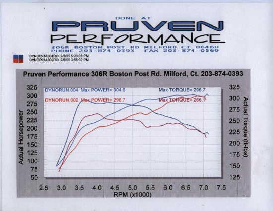

I had a hard time to figure out exactly which base tune to try out on this car since it had a hybrid HKS / Apexi combination so I was looking at it and it looked like a Buschur style filter with a cone so I tried the map for a Buschur filter
Looks like it started off good with some issues up top from the cam gears - need to lean it out on top and adjust timing
I took out the xede unit as I have no idea on how to tune it at all and installed a Hallman MBC at 21 psi peak and a Walbro 255 lph fuel pump - actually his mechanic installed all that in our parking lot as he brought his mechanic from his local mitsubishi with him b/c they are pals
Here is the Dyno Flash through the mail tune with hallman MBC compared to the previous set up

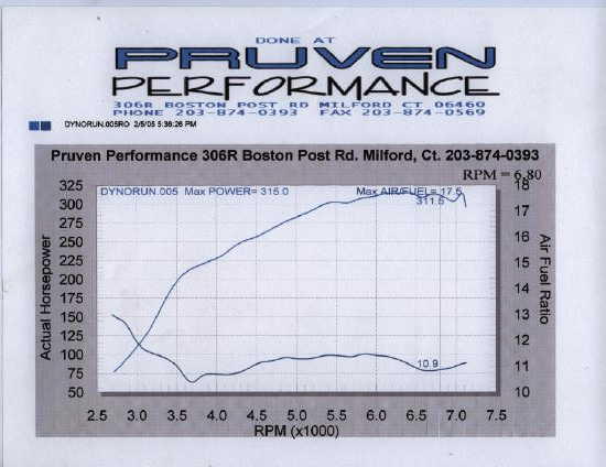

Here is the a/f print out - vetry close for a base flash

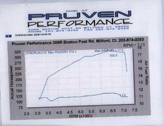

Working it a bit at a time

Step by step tuning to dial in the proper tune

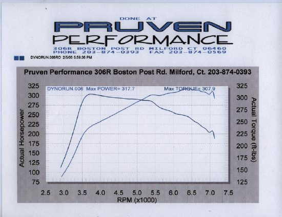

BTW - here is the final sheet
I wanted to say that the vishnu cam gears are very good
Clearly the effect on the tq curve is to even out the power band and make for a very smooth low end and much more power up top
The settings were spot on on the cam gears and a lovely addition for anyone who wants to get more 6,000 to red line power at the expense of low end tq. Obviously a lot of work went into dialing in those cam gear settings and they really smooth out the power band.
Personally I prefer the stock gear setting feeling where the boost slams on hard when it hits and then falls downa bit - BUT - I can see that this cam gear settings makes the tq curve almost FLAT through the middle and it may have big advatanges for a guy doing road raceing as it will come in real smooth out of the corners.
