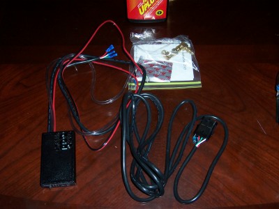

Guys - I am putting the aclohol kit in my car - wanted to post up some pictures and general directions which may help some people installing the kits
Some pics of thye kit out of the car

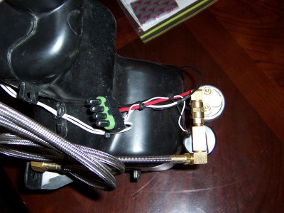

BTW - the gauge serves as a health meter you can ocassionaly check the pump out put to make sure everything is healthy and it also acts as a warning light - when it reached a pre-deremined level of pressure it activates a light in the control unit

Everything is very neatly installed into the stock intercooler tank - all wires are neatly zip tied and come with high quality connectors - the level is preinstalled in the tank with the pump and all fitings

Special oil to mix with your acohol - you mix in a bit with every gallon
The wiring harness - jet to install in the fmic pipe - evo specific instructions and control unit
