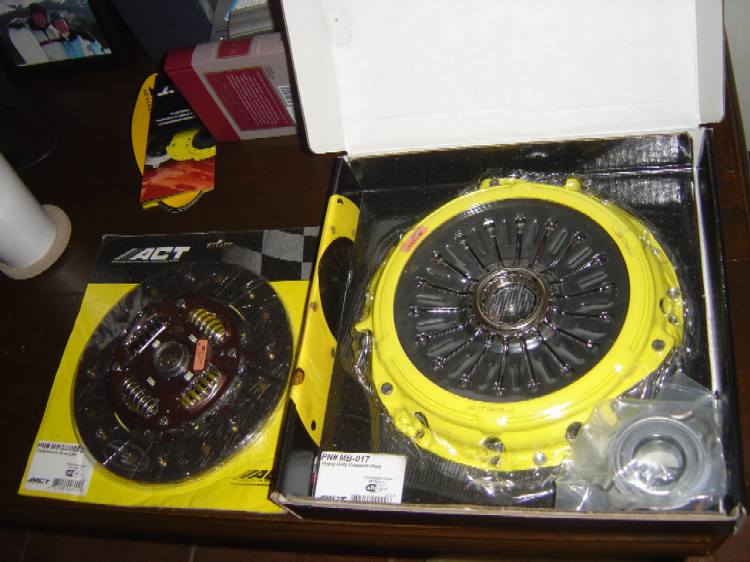

get a clutch before u launch!
are you talking to me?
