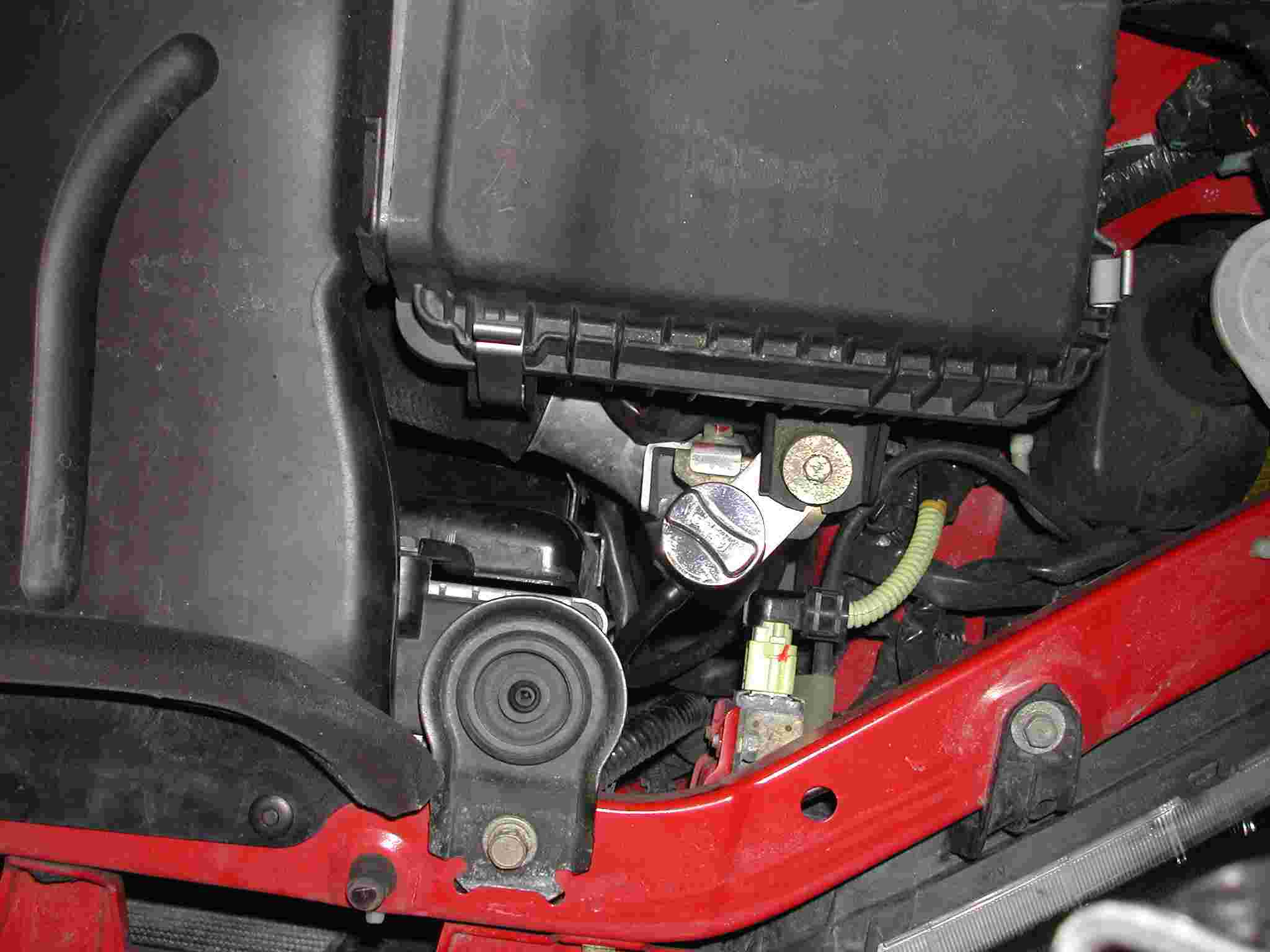

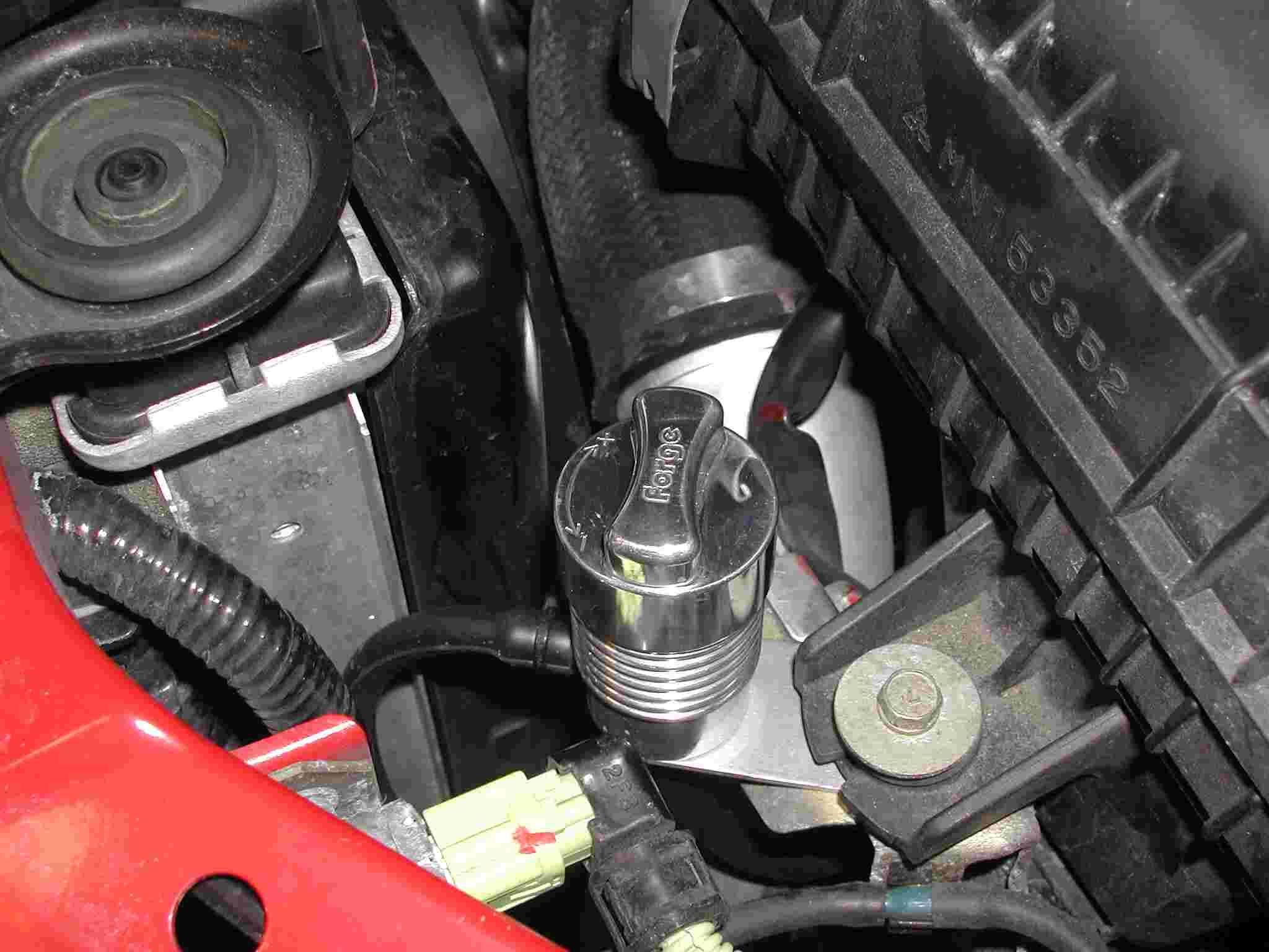

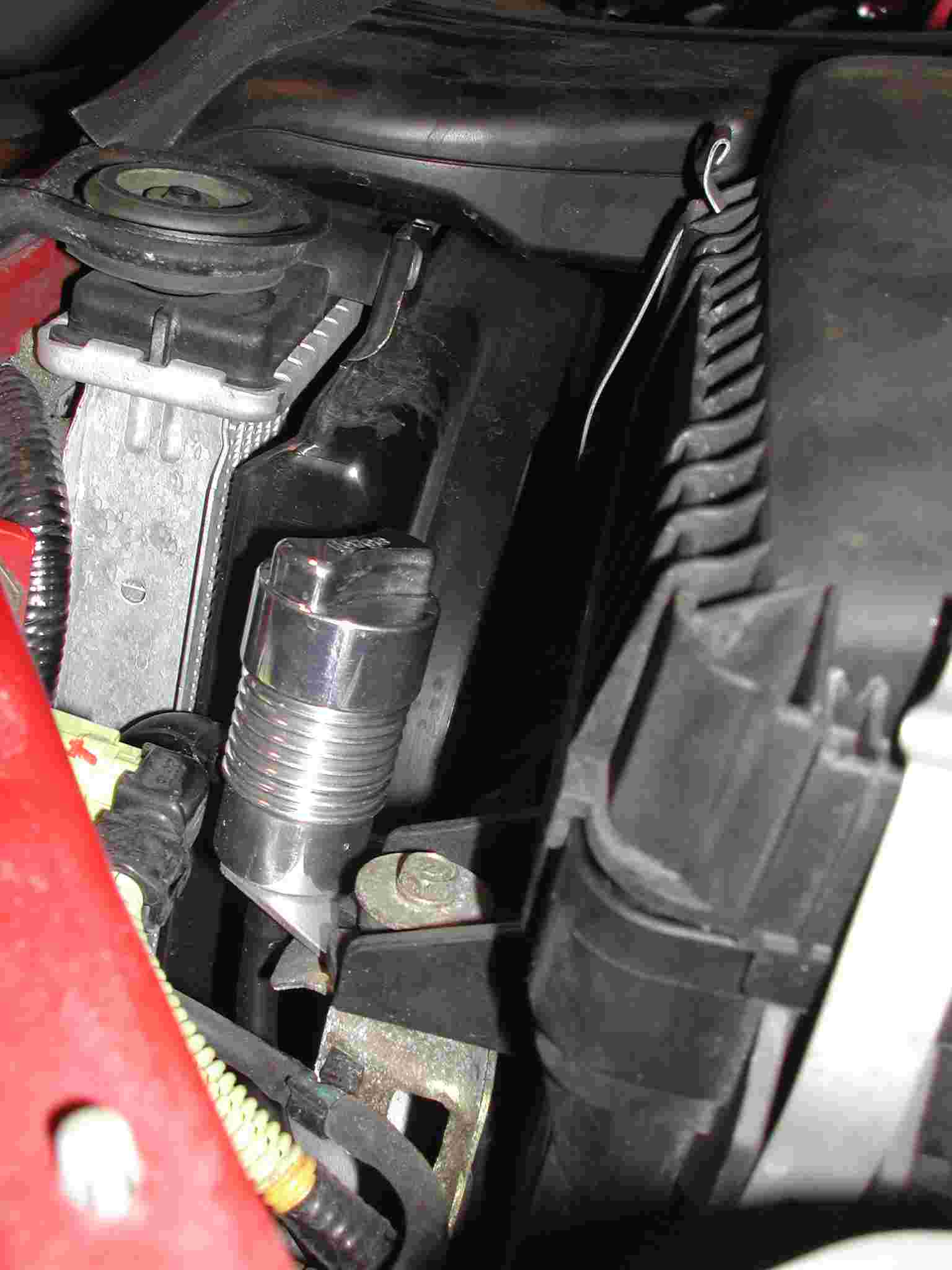

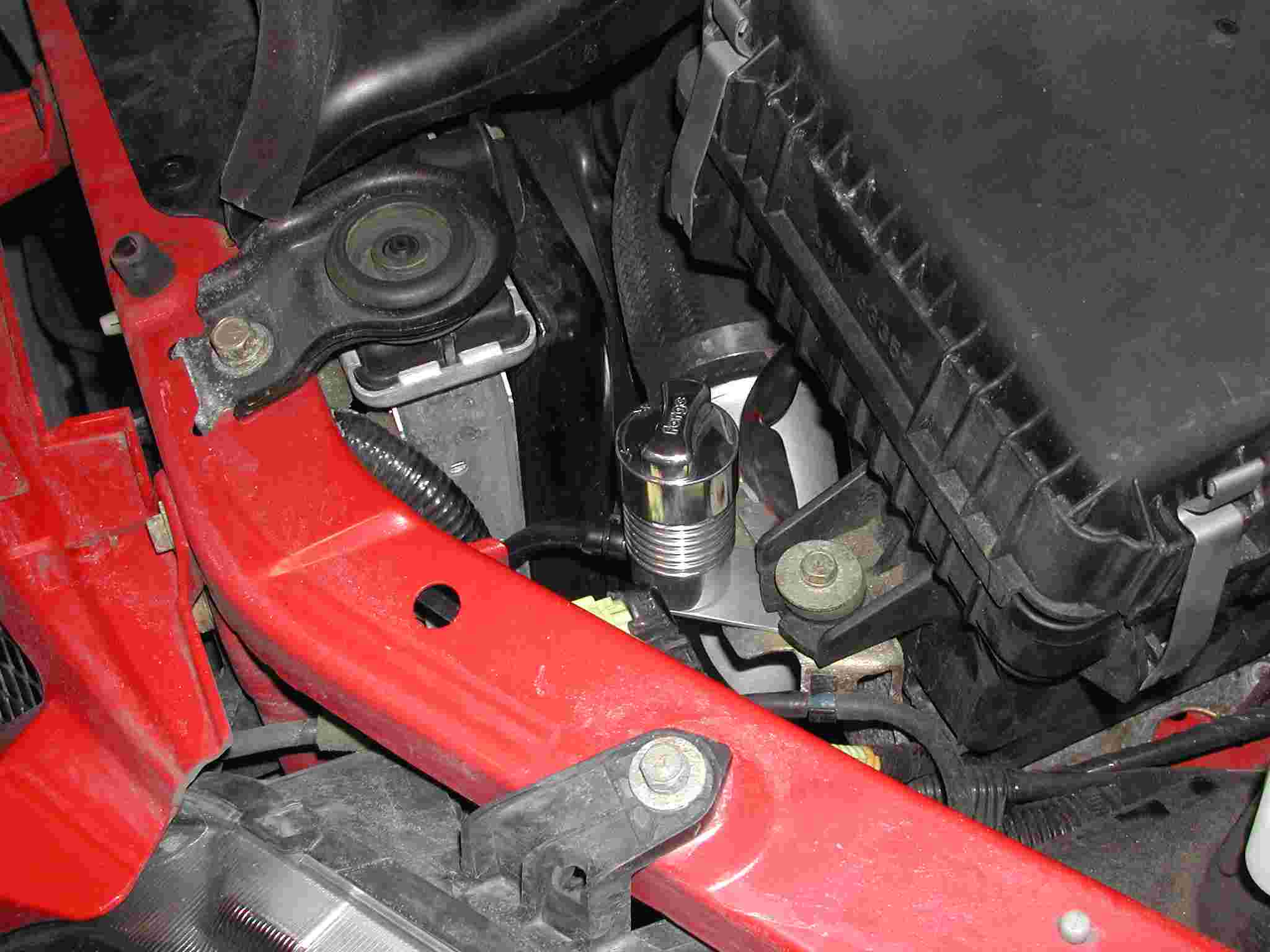

Pics of Forge MBC location
Maybe I should put these somewhere else, but it seems like there are 100 different threads on this subject. Anyway, this is the most convienient place I could think of to put it, I'm not worried about hiding it, and din't feel like drilling any extra holes in my car.
Attached Thumbnails Forge MBC install and use notes-dscn6463-1.jpg   Forge MBC install and use notes-dscn6464-1.jpg   Forge MBC install and use notes-dscn6465-1.jpg   Forge MBC install and use notes-dscn6466-1.jpg
Old Jan 30, 2006 | 08:57 PM
  #47
Jim_Patterson's Avatar
Posts: 765
From: St. Helens, Oregon
Looks like a convienent spot to me=perfect.
Old Jan 30, 2006 | 09:01 PM
  #48
Warrtalon's Avatar
Posts: 20,790
From: Long Island, NY
I have mine there, and there are about 6-7 Evos now in the area who all have it the same way after getting their Warrtalon packages!
