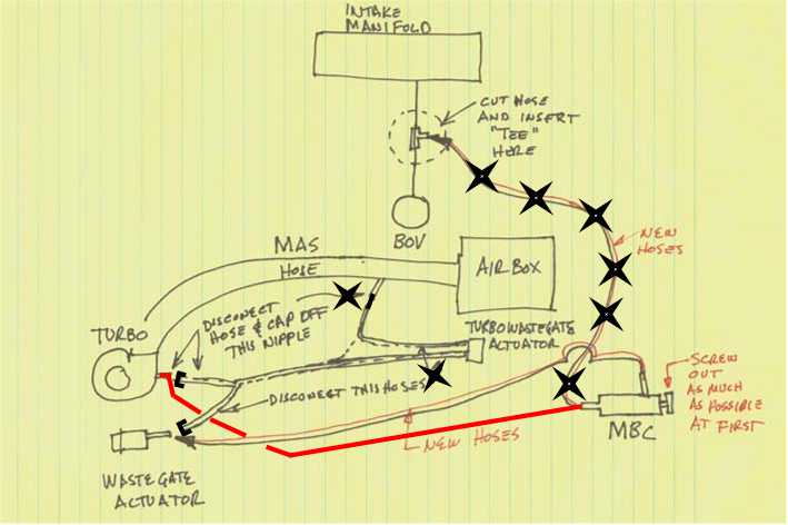

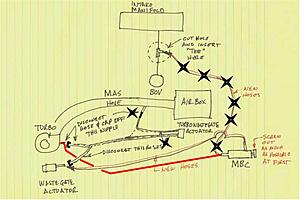

Yet another MBC installation
Originally Posted by TURBODAWG
You dont need to remove the one hose that goes from the stock wastegate solenoid to the MAF pipe. That hose is a bleed hose for the factory boost solenoid. If you cap off the other port to the wastegate solenoid, then that hose never sees any airflow. That is one less step and 2 less caps that are required. It also makes it easier to switch back to the stock setup if need be.
Looking at the previously discussed diagram and using the info from TURBODAWG, I simplified the installation to removing and capping only two vacuum lines(turbo and wastegate) and left everything else installed. See attached modification of diagram originally posted by https://www.evolutionm.net/forums/sh...0&page=2&pp=15
I have installed my Forge UNOS MBC this way and it appears to be holding boost just fine. I have not been able to thoroughly test it yet, its pouring rain tonight and its the end of the month(too many POPO out on the streets).
Anybody have any thoughts......
