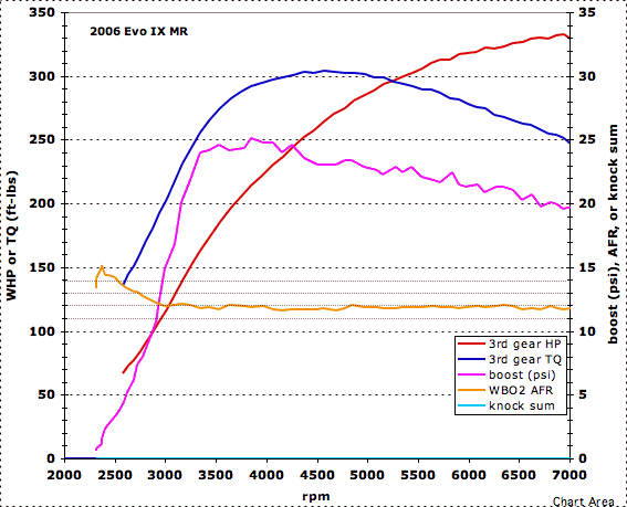

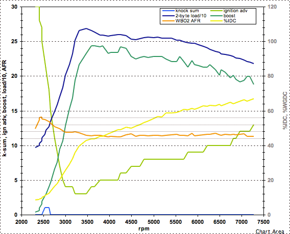

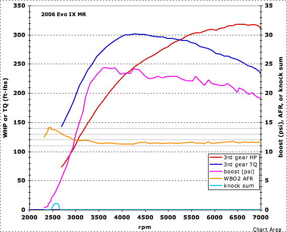

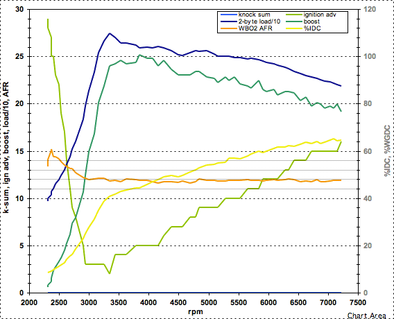

I'm one step away from being done fiddling around at pump gas boost levels.
What I've done thus far with my E85 tune:
1) Lean out the AFR from ~11.4:1 up to about 11.9:1 (gasoline AFRs).
2) Increase the timing between 5000 rpm and 7500 rpm by somewhere between +2 to +4 deg.
Increasing the timing has not caused any more knock, but has had only a mild effect on power. Logs and HP charts are below. The minor increase in power with no increase in knock for a fairly large increases in timing is good evidence that I've reached and probably passed MBT without knock. People have been saying for a while that timing doesn't give much power with E85. I had assumed that this meant more timing would give knock, but now it looks to me that its the real issue is that its easy to pass MBT without knock using relatively low amounts of ign advance. This makes the "high boost" tuning strategy for E85 easy to understand.
I can't say much about AFR yet except that 11.9:1 gasoline AFR with E85 is no problem. I'm curious if a little richer AFR might slow the burn rate a bit and perhaps make a little more power. My final step before upping the boost will be to drop the AFR back down to about 11.3:1 to see what effect it has on power. If no effect, then back to 11.9:1.
E85 "low ign advance" + 11.5:1 AFR datalog
E85 "low ign advance" + 11.5:1 AFR HP and TQ
E85 "high ign advance" + 11.9:1 AFR datalog
E85 "high ign advance" + 11.9:1 AFR HP and TQ
Attached Thumbnails E85 tuning notes-m65v16_afr_timing_load.gif   E85 tuning notes-m65v16_hptq.gif   E85 tuning notes-m65v23_afr_timing_load.gif   E85 tuning notes-m65v23_hptq.gif

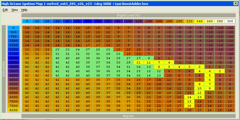

Here is my latest timing table. Yellow squares indicate cells hit during a 3rd gear WOT run with boost peaking at about 24.5 psi and tapering to 20 psi at 7000 rpm. After a bit more testing, I decided to keep the higher timing values from 5500 rpm to 8250 rpm, as they do result in about a 10 whp increase in power compared to when the timing is 1 degree less in those cells. AFR is right at 11.9:1 from 3500 to 7500 rpm. Some runs are knock free while others show random knocksums of 1. All cells to the right of the yellow ones are still untuned. Green cells indicate cells hit during daily driving.
I must say, I really like E85 because of its awesome resistance to detonation and its cooling effect. I feel like my motor has much less chance of getting trashed when I hammer my car with this stuff than with 92 oct.
