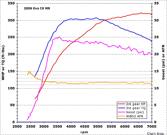

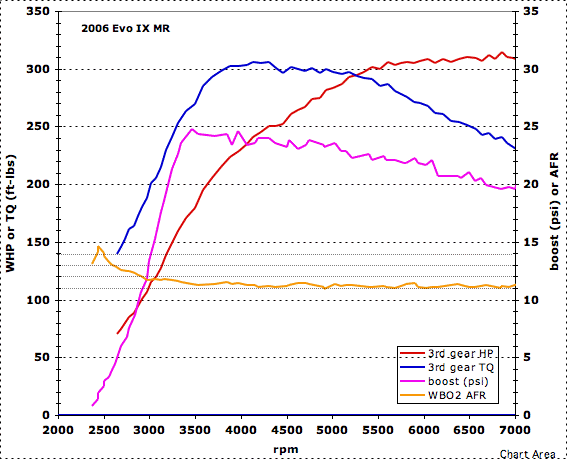

I leaned out the AFR from about 11.2 to about 11.6 from 4500 rpm to 7500 rpm and picked up about 10 WHP. I'm definitely closer to the knock threshold though. I got several more counts in my first run than I usually do. Second run was virtually knock free though.
Before
After
Attached Thumbnails E85 tuning notes-evoscandatalog_2008.06.23_13.32.38_3rd_hptq.gif   E85 tuning notes-evoscandatalog_2008.06.24_08.58.08_3rd_hptq.gif

Up that boost mrfred, if I can run 27.5 psi on 91, you can run that on E85 with real timing.
Run 25psi through the midrange if you can, you will pick up a ton of area under the curve.

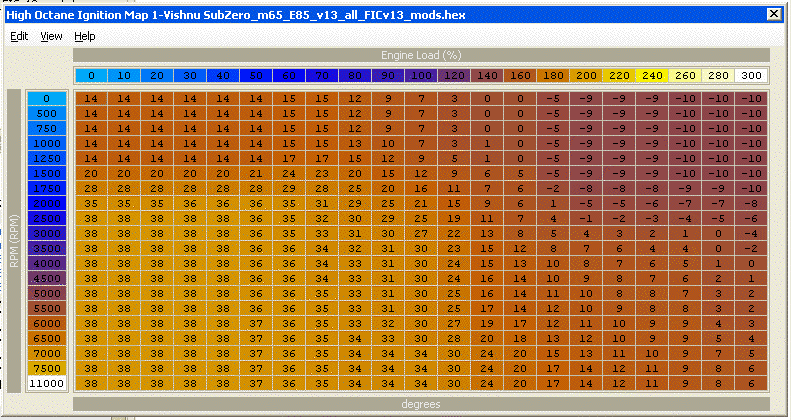

That's for the feedback on ignition timing at low loads. That's what I'm fiddling with again. I'm back to E85 for another three weeks, ... maybe longer if I can improve gas mileage enough to travel 240 miles on one tank during a road trip. So I'm fiddling again with E85 economy tuning... trying to get a feel for optimum ignition advance during offboost cruise conditions. I tried my current 92 Oct ign advance which has quite a bit more advance over stock and found that the car felt softer with E85 than with 92 Oct. There was virtually no knock with this map except at 70-80 load and 2500-3000 rpm. No matter what I do, the car seems spit out a knock sum of 2 in this range, so I don't worry about it. I pushed up ign advance by another ~2 deg in most all cells up to about 100 load. 15 minutes of driving wasn't enough to be able to tell whether its working. No additional knock though over the previous ign map. This is a situation where live tuning would really be helpful. Here are the before and after maps.
baseline map (my latest pump gas timing map):
+2 deg up to about 100 load:
Attached Thumbnails E85 tuning notes-v65_e85_v13_all_ficv13.gif   E85 tuning notes-v64_e85_v14_-2deg_ign_map.gif
