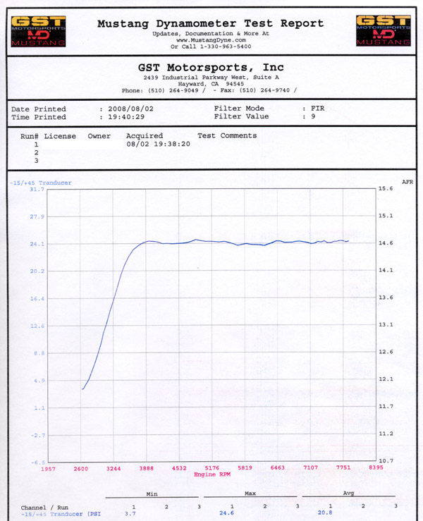

Yes cranking the WGA will help, it'll throw your BWGDC values all off, but it should help in the end. Also, just running more peak boost will help the end of your taper; it'll still taper but your end result will be more boost up top.
Here's my cranked WGA/GM BCS/open element/ix turbo on a viii/etc. result:
(this is on BP92/meth but you get the point)
Crank the boost up, seriously. That's what E85 is for
Just keep in mind the 8's hold more boost on "stock" turbos than the 9's do.

Originally Posted by scheides
Really? You mean a VIII with an IX turbo will hold more boost than an IX with an IX?
I have not noticed this!
On average yes. I contribute it to head design and mivec.
More boost does not always mean better. On some Evos with stock or variant turbos I have made more power with less boost. It all depends on what the car likes and of course the setup.
The Evo 8 I posted a thread about that held 24psi at 7800 actually ended up making more power with less boost. It wasn't an octane issue either as it was running 110 octane.
