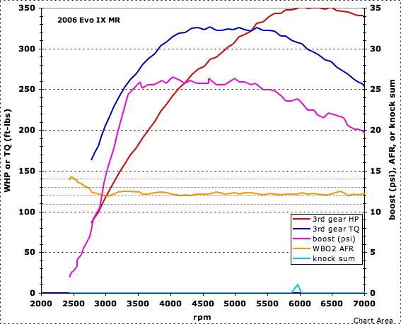

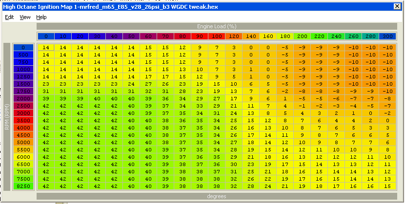

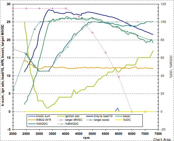

I think I've reached a pretty good spot with the high power tuning. I'm hitting ~350 whp and around 325 tq on my HP/TQ calculator. These values are a solid 50 whp and 30 tq over my 92 octane tune. Its not as much of an increase as most people are getting, but I'm running a cat and a nearly stock airbox. If anyone one has any suggestions on a cold air setup that flows better than stock, but isn't any louder than stock, I'm all ears. I'd like to do a Titek O2 housing as well, but no time to get into something like that.
HP/TQ and some EvoScan data are below. The timing table is shown below as well. One thing I've found with the timing is that I don't need to pull back much timing at the highest loads. What works at 260 load also works fine at 280 load. No knock, and not past MBT. I suspect that similar values will work fine at 300 load as well. I'm still a bit chickensh*t about pushing up the timing at 3000-4000 rpm though. Even though I'm pretty well convinced that E85 is knock proof with a good AFR, my car is a DD, and I don't have the time to deal with breaking something in search of the last few hp and tq.
One last tidbit is that I took some baro measurements on some of my recent road dyno runs. I'm seeing a consistent 0.7-0.8 psi of vacuum at the MAF at the highest airflow values. I'd be curious to see what baro values people get with a good open element intake.

nice stuff. I've found that 3-4500 doesn't like alot of timing on E85.
I still need to do those logs for you mrfred, sorry it's taking so long. I haven't been driving the evo much in the last week or so. I am interested in the MAF vac though.
The Data.xml file I sent to you is set up for the MAF vac reading, so it will be very interesting to compare your airfilter setup (disco potato airfilter in a stock airbox with bottom cutout?) to my nearly stock airfilter setup.
EDIT: BTW, how are you determining the timing at 3-4.5K, knock or MBT?
Old Sep 22, 2008 | 10:43 PM
  #89
RazorLab's Avatar
Posts: 14,094
Likes: 1,093
From: Mid-Hudson, NY
Knock actually, get a little 1-3 count noise that goes away with less timing.
Here is some baro data from the Ebay filter test I did a while back: https://www.evolutionm.net/forums/sh...=277802&page=5
At 20psi boost, with the stock airbox/filter I saw .95 psi pressure drop and with the Ebay filter I saw .37psi pressure drop.
Eric
