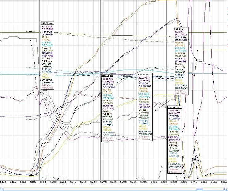

OK, I went ahead and bought the Ebay filter and did a back to back run comparing it to the stock airbox and stock paper filter (dirty filter, too).
Quick summary:
I got about the results that I expected: less pressure drop, but increase in IAT. Overall, even without a tune, the Ebay filter did show minor power gains, even with less timing and a richer AFR. With a tune, there would be more power to be found and even more so if a proper cold air box was built. (The test was done at low boost of only about 19psi peak, so higher boost levels and greater airflow would favor the cone filter because the pressure drop with the stock setup would continue to increase.)
Log Review:
In my comparison, I wanted to make sure that I logged intake air temperature and barometric pressure, since the true test of an intake/filter is to see the change in air density at the MAS. Intercooling has the final say after the turbo, but for the sake of this test, I was simply testing the two intake setups.
The downside to a cone filter that doesn't have a cold air box is the increase in IAT. The downside to a stock airbox/filter is the fact that is is restrictive and causes a pressure drop. I remember doing some calculations a while back and came up with about 25* increase in IAT was about equal to a 1psi pressure drop (my math could be off). So, if your cone filter had 1 psi less pressure drop, but increased IATs by 25*, it might be a tie ballgame. Although, the higher the HP you make, and thus more airflow, the more and more the pressure drop would increase, where the cone filter may win out, even with increased IATs, since the increase in IAT shouldn't really change with increased airflow.
Anyway, in LogWorks I created a formula that will calculate the air density at the MAF for me. All I have to do is log the baro and IAT. I have also used the MAF scaling tables to calculate mass airflow, but I haven't done the two-byte mod for airflow, so my numbers are only good up to the 1600 Hz mark (if the calcs are accurate).
Here is the log(hard to see here...the solid lines are ebay filter, dotted are stock):
The first box shows the baro for both runs starting at 14.80 psi. By the end of the runs, the Ebay filter was at 14.43 psi and the stock setup was at 13.85 psi. A .37psi drop for Ebay, .95psi drop for stock setup.
Winner: Ebay air filter
The first box shows the IAT at the start of the run for stock setup was 35.3*C(95.9*F) and for the Ebay filter 30.1*C (86.16*F). By the end of the run, the stock setup was at 25.2*C(77.36*F) and the Ebay filter was at 31.3*C (88.32*F). An 18.54* drop in IAT for the stock setup...a 2.16*F increase for the Ebay filter.
Winner: stock airbox/filter
Note: In the middle of the run, the Ebay filter got up to 34.1*C(93.38*F), before slightly decreasing.
Note2: This is also with the stock cold air snorkel and airbox lid on top of the Ebay filter to help direct cooler air to the filter.
So which one was better? Well, by the end of the run, the stock setup showed and air density of 1.136 g/L and the Ebay filter showed an air density of 1.155 g/L. So, about a 1.7% increase in air density.
Overall winner: Ebay filter, with a slight increase in air density and slightly quicker acceleration through the run, even with less timing and a richer AFR during much of the run. I would imagine that as the boost levels increase, the Ebay filter would widen it's gap even more, since the pressure drop would just continue to increase on the stock setup. With a properly built cold-air box and a tune, the Ebay filter would gain a lot more over the stock setup.
Next, I will tune and build an air box and see what I get. Eventually down the road, I may even test a modified stock setup with the airbox lid cut out.
Eric

^^ good write up . So in general it seems the Ebay setup doesn't throw the MAF readings to far off? I think for me the biggest reason to keep the stock box was because it didn't mess with the MAF readings and I wanted as few variables as possible.
Old Jun 30, 2007 | 01:27 PM
  #64
l2r99gst's Avatar
Posts: 3,499
From: CA
The maf readings seemed to be pretty much unaffected, or very little if any.
