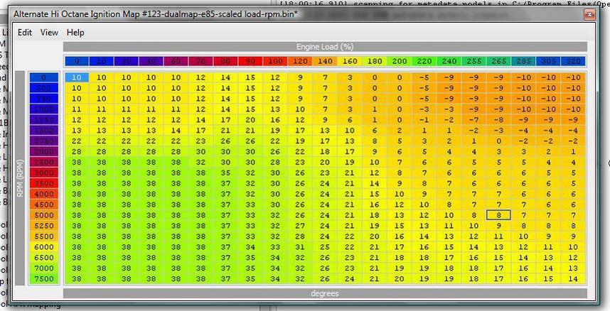

here ya go. I think I may be able to run a little more up top.

Here is my latest with no knock what so ever. She rips. This is with a peak of 27psi and tapering to 25psi.
