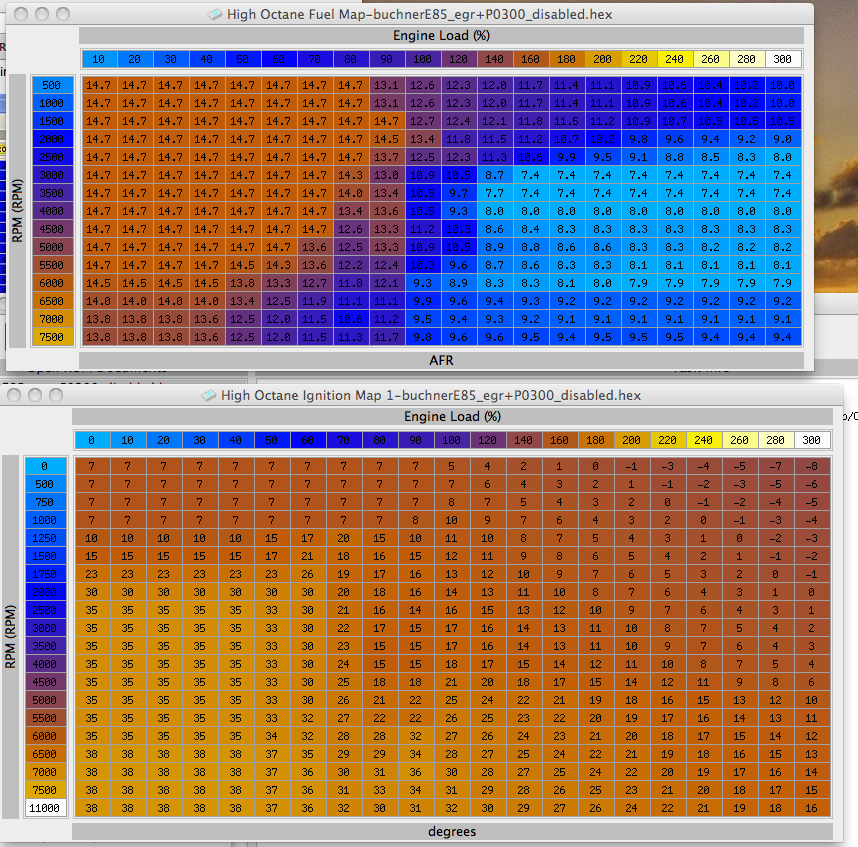

  #80
buchnerj's Avatar
Joined: Jul 2007
Posts: 1,497
From: the burgh, pa
Mine. Mods in sig.

Originally Posted by buchnerj
Mine. Mods in sig.
You're not going over 300 load with that setup? It also seems a little rich for E85, unless that's your pump fuel map.
