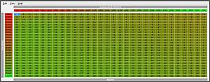

Old Jun 24, 2012 | 05:53 AM
  #127
boostleak's Avatar
Joined: Jun 2012
Posts: 43
From: 4 door saloon
Newbie here, Hows my timing map look?Tuned on E85 a couple months ago. Thanks
