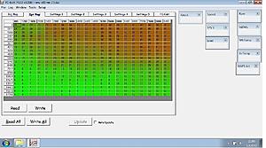

Old Mar 5, 2012 | 11:03 AM
  #120
umppa's Avatar
Joined: Feb 2012
Posts: 1
From: finland
Any comments about my ignition map. Im hitting ~11000load, so there is ~10degrees of advance.
