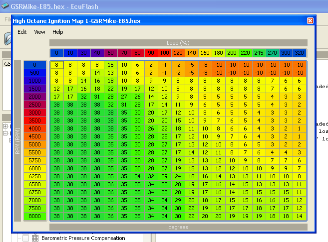

From: Northwest
Track the 320 load range from 4500 to about 6000 and then track the 270 & 300

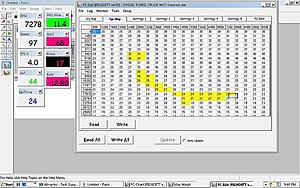

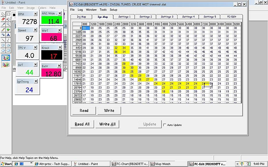

excellent thanks, i will keep that in mind, my RB runs a stock bore size of 86mm.
My tuning software works differently, works off a mixture of TPS airflow meter signals (x2 for twin turbo) etc.
below is a screen shot of a 18psi PULP run making 293kw
from left to right is how my car traces
In the Nissan world, TP = Theoretical Pulsewidth, not throttle position. TP is derived from an equation that accounts for MAF voltage, RPM, # of cyls, injection multiplier...I found that even on pump gas my RB26 liked a lot more timing than most evo's run. My E98 timing would be considered absurd on here.
