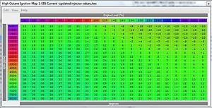

I will stop lurking and share what I have.
06 Evo IX / 1450cc Fic / 30R
Let me know if you think something is off the grid. I'm ok with feedback. I have not been dyno'd. Generally keep this around 27psi, but have increased to 30psi a few times. No knock

I just switched to E85, so hopefully I will get some time this week or weekend to tune my timing and AFR.
Quick question for you guys, though. Are you using a tool like the Virtual Dyno to plot the hp/tq changes for successive pulls while you slowly ramp the timing up? From what I understand, it's pretty easy to get to MBT and past without any knock on E-85 and if you are going past MBT, then you are losing power and giving your bearings a beating, which can eventually lead to an engine failure.
Just curious about the methods that everyone is using. When I tune this week/weekend, I am going to go up about 1-2* at a time and plot each pull on the virtual dyno to see where MBT is, then back it down a bit.
For those who have found MBT or use this method, can you mention a few load/rpm/timing values for MBT for your setup?
Eric

That is exactly the way its done!
Some use a dyno, some use DLL, some use the HP and TRQ calc in EVOscan, but most have switched to JackOfTrades Virtual Dyno.

Also, it would be best to use the same road each time for your virtual dyno pulls. If you are adding 1-2 degrees and only getting a delta of 5hp it's probably time to stop.
