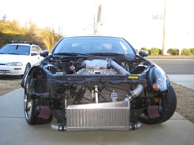

Old Aug 13, 2010 | 11:15 AM
str8dum1's Avatar
Joined: Jul 2010
Posts: 8
From: raleigh

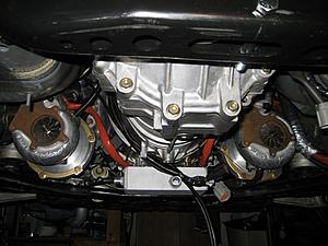

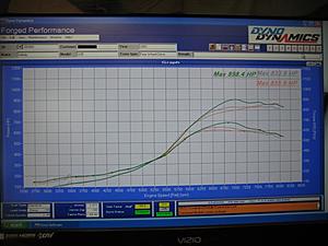

Pretty standard build with dual intank walbros, PTE1200cc, Haltech, JWT cams but super laggy with the 3.5l.
Rebuilding right now with a 3.8L BC stroker, carrillo rods to push the power to the left some.
Getting parts together for the E85 swap when I get the motor back.
Attached Thumbnails setting up Zeo ECA and FF sensor-engine-swap-265-800.jpg   setting up Zeo ECA and FF sensor-engine-swap-391-800.jpg   setting up Zeo ECA and FF sensor-engine-swap-338-800.jpg

Very nice! Are there any single turbo kits for your car? You could spool a huge turbo pretty fast with all 6 cylinders and move the curve well to the left.

or do twin turbos but use a smaller snail.

Wow! Peak torque at 7,000 rpm. That G35 must spin the tires at the END of a 0-60 sprint!
