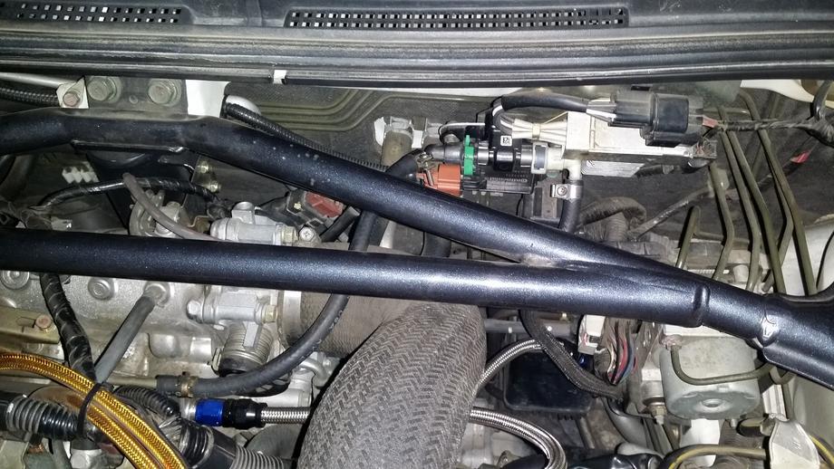

The flex sensor is equipped with tubing that accepts standard push lock EFI connectors. I recommend you bolt it to the firewall using the stud just above the heater feed and return hoses.
See here: https://www.evolutionm.net/forums/at...position-2.jpg
Use fuel hose and some barbed EFI connectors to plumb it into the return hose. This will be easier than trying to braze it into the return line above the intake manifold, which is actually cadmium plated steel tube.

firewall is going to be a cooler location than above the intake manifold. i plumbed mine without efi connectors by using larger size hose in combination with reducing barb unions to connect to the factory diameter hose.
