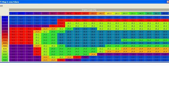

Can someone get me a good screenshot of the JDM IX RS MIVEC map? The screenshot in this thread is low quality, I can't make out some of the values. Plus I set my definition wrong on the JDM IX RS map I've downloaded -_-... thanks.

Here is what I gathered from it.. I'm guessing on the darker colors..
Someone with the actual map, please verify?

Red and Purple cells are the only things I'm questioning.. is purple 4.8 and red 9.6? Thanks..

This is what I'm using, base from the RS mivec.
