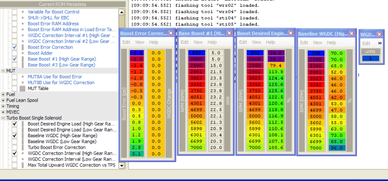

Following this thread's pill replacement procedure, I am only hitting ~15 PSI peak. I installed a #58 pill in the line between the turbo and Tee and removed the pill at the solenoid since I'm implementing the new ECU direct boost control ECUFlash mods. I have zeroed out my BEC table just to see what the car did - would this be the cause of the low boost? If I start adding values into the BEC table, should I expect the car to actually hit my target boost or do I also need to add more aggressive MWGDC values? Here is what I currently have programmed:
