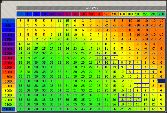

I created this timing map based on the xede timing that I log. I changed the main cells and those that are adjacent to them. Does it look any good?
The car has a TBE, the AFR is in the low 11:1, a fuel pump and a JDM DV.

seems a bit too advanced at peak torque. for 91 or 93 that might be a little too advanced. just try logging a pull.

3* to -1* is too much at peak torque? The real determining factor is the amount of boost being used at peak torque and the rest of the powerband for that matter.

Exactly..the timing map seems ok just need to try and smooth things out a bit, you have a few big jumps here and there.

Just to add some more info. The boost is set to 22 psi peak and tapers to 19 by redline and the gas is 93-94 octane.

Could you point thoe jumps to me on the map so I can fix them?

looks fine to me. I run a bit more timing then that, all over the place, with the same 93 octain and 24psi.

That boost level and that fuel I have tuned cars to this map:
The car with this map now has cams (GSC 269's) but before that, it ran that midrange timing. All the same listed mods that you have with a 9.8 hotside. He ran 12.6's on pump with no problems and faster at higher boost and some 112.

i have a quick question, how come you rescaled to 320 rather then 300, do you actually hit load higher then 300 with only 22 psi tapering down? If so is it because of the cams? If not dosent 7* at peak torque seem pretty high?

For 93 octane and 22 psi at peak tq, 5 deg is a good ways away from too much. Regardless, it really matters what his car thinks about the numbers and not what we eyeball on the board.
