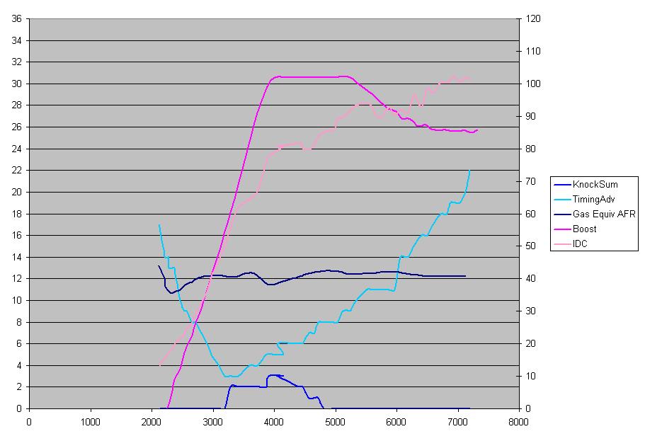

The Duty Cycles are interesting. In the pull I did last night I passed 100% IDC at 6700 RPM. At that point my boost was at 25.7 psi and my A/F ratios were at a gasoline calibrated value of 12.2. The attached graph shows the pull. Everything except the IDC is scaled to the left axis.

Wow, maybe you needed the 1200 or even 1600's unless you can lean it out more without issue. You have your injectors scaled to 550?
Actually if it doesn't lean out over a LONG hard 5th gear pull your probley OK.
I ran one of my subies like that and it would only lean out enough to cause knock if I was going about 150mph. Basicly maxing the car out for a long time I could see the AFR's gradually go up point by point.

I think I may try a twin fuel pump setup and see if that lowers the duty cycle. My current issue is that the Full Blown setup is a little pricey and I can't send my fuel pump housing to Buschur because my Evo is my daily driver. I've been looking into modifying my own fuel pump housing to hold two Walbros. If I'm looking at things correctly I should be able to do the full modification for ~$50-$75 (I already have an extra Walbro). I'm very anxious to see if that type of modification will help.

Thats what I did on my subie. The twins didn't work for whatever reason so I bought the Walbro modified from BR. That has worked fine so far.

I could just about guarantee that your single walbro is losing fuel pressure up top and a twin pump will lower your duty cycles. I just did some quick math and proved that you are most likely compensating for you fuel pump not keeping upwith a 1:1 rise in fuel pressure and therefore have to run larger pulsewidths (duty cycles) for your injectors.
The only reason I can't guarantee this is because I don't know what the white rabbit turbo is actually capable of flowing...I have never seen it's compressor map. But, I checked two ways and both ways suggest that you are losing pressure.
Keep reading for the long boring math:
1. To get a rough estimate of how much mass airflow you were pushing you can use the equation for airflow through an engine:
airflow through engine (CFM)= rpm*cid*ve*PR/3456
6700*122*.9*2.75/3456=585 CFM
585*.0756=44.2 lb/min
There are a few assumptions in this equation, like standard temperature for the CFM to lb.min conversion and .9 VE, but roughly, at that RPM and boost, you should be flowing around 44 lb/min mass airflow through your 2.0 L engine. I think that falls in line with what the white rabbit is capable of, so that makes sense.
2. Now, we can see how much mass airflow maxing out 1000cc injectors would indicate:
desnsities at 60F
ethanol 49.3 lb/ft^3 = 1.74*10^-03 lb/cc
gasoline 42.5 = 1.5*10^-3lb/cc
e85= 1.704*10^-03 lb/cc
1000cc injectors at 100% duty cycle =
4000cc E85 = 4000*1.704*10^-3 = 6.816 lb E85
You said that you were running at a gasoline calibrated AFR of 12.3, so in lambda that is 12.3/14.7=.8367
Stoich for E85 is ~9.765
Your true AFR for E-85 was (12.3/14.7)*9.765= 8.17
So, to find how much mass airflow this AFR indicates, just multipy your AFR by mass of fuel:
8.17*6.816=55.7 lb/min mass airflow
So, I highly doubt that the white rabbit can flow 55-56 lb/min of air, that's well past a 50-trim, a 20gLT and most gt 30s, like the 3076. And this was at 6700 RPM to say the least.
Also, the fact that this 55.7 lb.min was much larger than the quick estimate of around 44lb/min of airflow at that point, that is showing me that your fuel pump is losing pressure and to feed enough fuel into the engine you must compensate with larger than normal injector pulsewidths for that mass airflow, and thus the reason why you need such large injectors.
So, to sum it all up, I think you would definitely benefit from a dual pump setup. I think you could easily drop your duty cycles (using a little math again) for your 1000cc injectors to more around 80% at this same RPM and airflow.
