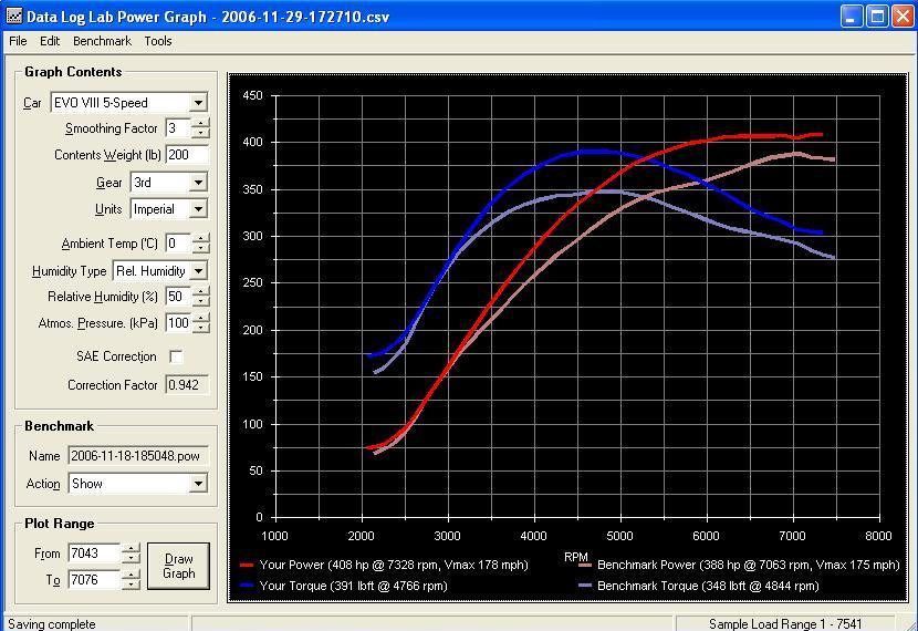

After a little more tuning I'm very happy with the results. I still think there is more power to be found in this fuel, but it takes a while because the only time I have to datalog is during my drives to/from work. Below is a Data Log Lab dyno graph comparing a very strong 93 octane pull I did earlier this month to a pull on the same road tonight.
-Paul

Old Nov 29, 2006 | 07:43 PM
  #35
JohnBradley's Avatar
iTrader: (30)
Posts: 11,406
Likes: 78
From: Northwest
E85 also requires more timing so dont be afraid to go to an aggressive timing curve. Heck even the infamous sea of 8's would work, but the point is it has a slower flame front speed so thusly more advance is needed.

Old Nov 29, 2006 | 08:06 PM
  #36
PVD04's Avatar
iTrader: (23)
Posts: 1,503
From: Wisconsin
I've decided to start playing with the boost first and then will work with the timing. As of right now I just log my drives to and from work and retune between each drive. It takes a while to get things fine-tuned but unfortunately I don't have time to do a lot of tuning runs during the week. Tomorrow morning I'm going to bump the boost up another couple of pounds and see how that works, although I'm supposed to get 3-5" of snow tonight so if it's still snowing for my drive to work I won't get to do any WOT pulls. After this boost jump I'll start playing with the timing.
-Paul

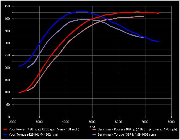

More power with more timing
I did a little playing with the timing, adding a couple of degrees in the middle and top. Mitsulogger picked up 3 counts of knock near peak torque so I think I may have reached my limit there, but there might be a little more left at the top end. Below is a comparison between my best pull from this morning and my best run from tonight with a little more timing. For people that may be questioning my numbers, the speed graph shows that it takes me 2.93 seconds to go from 40-80. Also, other than any weight savings from replacing parts, I have not pulled any weight out of the car.
-Paul

Old Nov 30, 2006 | 08:53 PM
  #41
Jeff_Jeske's Avatar
iTrader: (66)
Joined: Jan 2003
Posts: 4,358
From: On the track
Be careful with adding timing. Its possible to have bad things happen and not see knock.
Old Nov 30, 2006 | 09:00 PM
  #42
PVD04's Avatar
iTrader: (23)
Posts: 1,503
From: Wisconsin
I'm still at only 7 degrees at 3500 RPM and gradually increase to 20 deg right around 7000 RPM. I chose to start off very conservative with my timing so I still have a bit of headroom before I run into any trouble.
-Paul
