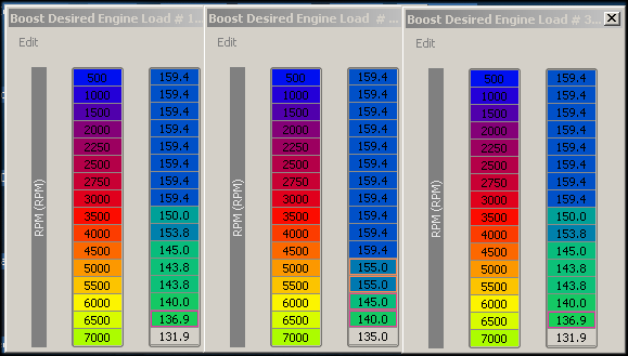

A friend of mine shared a flash with me. He tells me that it is possible to control boost with ecuflash w/o an MBC/EBC. I looked up the boost section of the flash and found the following changes from my stock rom. Could someone please explain these to me? I did a search and I still have some questions.
At the top are the modifed boost tables and at the bottom are my stock ones. From left to right:
Boost control load offset set @ 100 from 60 stock. Why? What does that mean?
Boost cut delay timer set @ what seems to be an arbitrary number from 1000. Why? What is it for?
Boost limit set @ 319. I understand that this one is maxed out, correct? What does 319 translate to psi?
Boost desired engine load 1, 2, & 3. I read that number two is the one that is changed but I have no idea why. And it is maxed out. Again why? Number 1 and 3 are only changed from 6000-7000 rpm and are set @ 140. Why this number?
This is added to the boost target to give target load.
1000ms (1 sec) with the load over the cut and it will fuel cut.
319 engine load. Low 30s PSI. I don't think engine load could ever exceed 319 though.
Change them all together. 219.4 load target (159.4+60).

I'm saying that 219.4 is the load target you get with the original table of 159.4 and the offset of 60 added together. I'm not recommending this as a target. So 250 might be sensible for a tame tuned pump fuel car - about 22 PSI depending on temperature and RPM but this is usually about right for the midrange on a stock MAF sensor/airbox. You could do this with a 100 offset and a 150 boost target.
255 fuel cut would be about 1.55 bar in the midrange, multiply my 14.5 to get PSI.
Yes the maxxed out timer for boost cut is set so that it never gets to cut the fuel (along with the 319 target that will never be exceeded).

You need to decide what boost to run depending on your spec and octane. Work in bar absolute manifold pressure and multiply by 100 to get the approximate load at least for the midrange. So 1.5 bar boost is approx 250 load. At 6000 RPM, 1.5 bar boost is more like 235 load on my car.
I would set all three (or four) boost target and duty tables the same until they are fully described as to how they work. This works practically with what is known about the ECU at present.

I think he was saying for the boost desired engine load set the mid range to about 150; but still let values taper up top(as he said 1.5bar in the mid-range is about 250=150+100, but at 6000rpms 1.5bar was about 235=135+100).

Going by what jcsbanks said, assuming you are setting your midrange desired load to ~250 (150+100); then since he recommended 20 over your desired load that would be ~270 for your mid-range for boost limit. Setting it to 319 pretty much makes it useless.

So make the desired load boost tables look something like this. This is with 100 offset.

Yeah, I read that thread. But most are trying to control boost by removing the solenoid pill or resizing it. I want to set peak boost to 22-23 psi peak and let it taper to about 19-20 w/o removing the stock pill or using a modified one.
Is that doable given the tables I posted?
