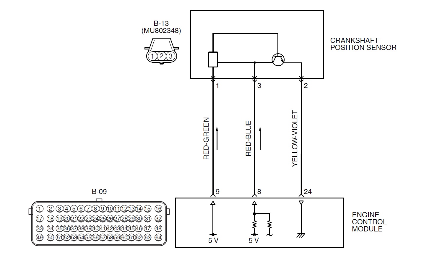

Crank signal values in evoscan
Hey guys. Got a question.
Just getting back into the scene again and curious what crank signal should read in evo scan while cranking the car ?
any info would be great having a serious no start issue.

Firstly have you checked the signal at the crankshaft position sensor?
It's a Hall Effect sensor and you would put a multimeter set to DC Volts.
Connect the + lead to pin 3, - lead to pin 2.
Better yet find 8 & 24 on B-09. The sensor must be in circuit and getting 5 volts to test.
Roll the engine and look for voltage fluctuating from around 5 volts to 0 as it rolls.
I'll have to look at evoscan to see if the signal is present there. I'm going to the source of the signal.
Get back soon. I'm an EE and love electronics. Electronics that works when it should!
