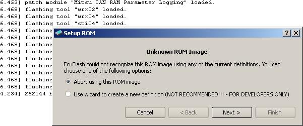

Alright, so i put my injectors in an she seems to be running worse than before which leads me to believe the previous owner 'tryed' to tune for the 1000cc's. I installed ECUflash an re-installed Evoscan to finally connect to my car an start datalogging.. but, now i'm having trouble finding the RAW rom files to upload on ECUflash in order to flash my car with the stock roms (97250001).. When i try uploading the .bin file in your second link, it gives me this error:

You need to have the correct .xml definition file for the ROM as well as the rom file itself.
You can get the 97250001.xml file from http://code.google.com/p/ecurom/sour...tsubishi%2Fevo.
You'll also need evo7base.xml.
Copy those two files into your ecuflash rommetadata\mitsubishi\evo directory, restart ecuflash and try again.

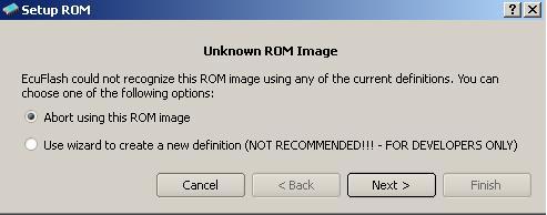

Done, k, now it says folder already contains a 'evo7base' file...Do i replace the existing file?
Thanks alot for your help man guiding me through this!
EDIT: I replaced the existing file, but made a back-up copy before i did. (Just incase)
Now i get this error on ecuflash start-up:

Couple more screens to see if i'm on the right path.. Keep clicking next? lol

If you keep clicking next, EcuFlash will generate a new empty definition for your ROM. Don't do that. Which version of EcuFlash are you using?

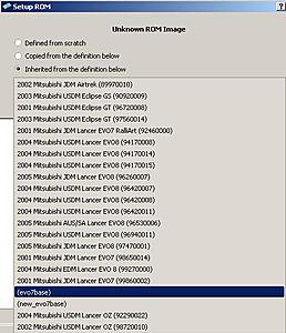

I'm using the latest version from the evoscan website.. 1.43.0.3252.
I had to choose a definition because it wouldn't recognize the ROM image using the current definitions. If i choose to use wizard to create a new definition, there is a drop down list. Which one would i choose?

If you use the wizard to create a new definition, it will be empty and you can't do anything with it.
Maybe try grabbing the 97250001.xml and evo7base.xml files from http://www.evoscan.com/roms/mitsubishi/ and replacing the ones you already have.

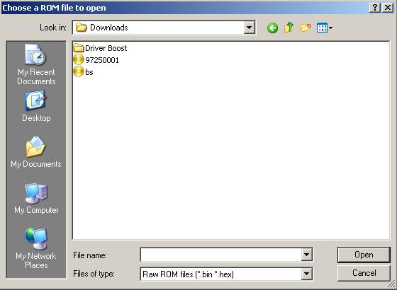

I downloaded an put both those .xml files into the rommetadata/evo folder.
The ROM file(.bin) i downloaded from from your 2nd link.
I try to open the ROM (.bin) file from ECUflash, an i get the same error msg (error2 attached in earlier post, post #1012)...
