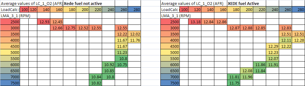

nj, compared to xede that -4 fuel =-1AFR, how does the ECU respond to changes, -1or +1 fuel map= ? change AFR
This is the formula that jjf posted in my thread when I asked this question
https://www.evolutionm.net/forums/sh...99&postcount=4
Here is the thread:
https://www.evolutionm.net/forums/sh...d.php?t=252986
The formula really works and I can get very accurate AFR targets in the fuel tables.

Thanks , I already have datalog of the xede tune AFR values, and AFR values with xede fuel Zero'd out. I'll try and use the formula to change to the desired values.
I ask because what I found out is that the Xede changes(offset) both the fuel and timing load cells. Meaning that with the xede fuel map cell (5k,240) is being offset, with the Xede map at 0 the cell value is (5k,260) which already is a leaner value.
Temps droped to the mid 40s that day and AFR show .5 leaner than in 70*F
The Xede offsets the Maf values higher in upper RPM range, red dots indicate load cells hit.
