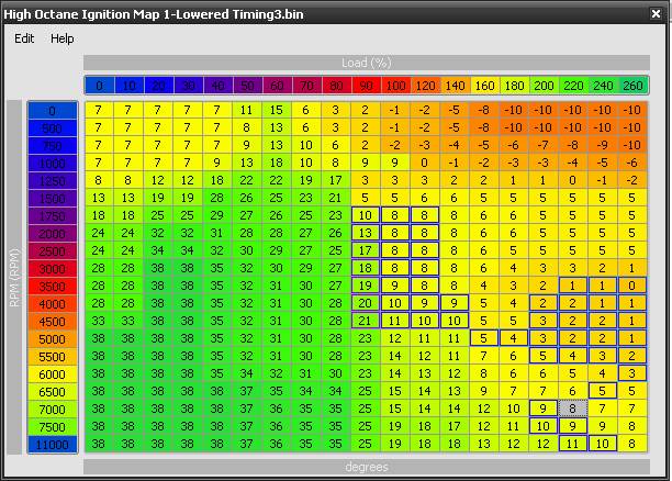

Getting closer to 0 knock
Geting 3 knock atm with a quick spike to 4 knock count dropping as it climbs to redline.
I move the timing down 1 degree in the highlighted boxes. The ones at low load are based on logs I took at normal freeway speeds see'ing tiny knock blips when the load increases a little so I'm backing off the timing a hair.

im not an expert, but here's something you can try:
level your timing at 3k 200 220 240 and 4k 200 220 240 to 2* and see if that block helps.
Also isnt 12afr a tad high for 220 load?

Shouldn't be too bad,
You seeing the 3000rpm right? Boost is still building at that point and the AFR drops to 11.5 by the time its really going. I guess I could increase the fuel a little at like 180 200 load points at the 3000 rpm point and get it to drop even faster.
