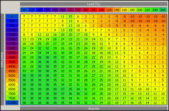

I concurr with Ludi and iTune. Make your AFR 11:1 and taper it to 10.9-10.8:1 and then increase your timing fro more hp and torque.
For reference this is the timing map that I ran when I had my 8. Boost was set @ 20-21 psi and tapered to 17.5 by redline.
Map definitely appreciated.
I think the upper timing may be too high for me right now with my load dropping off so fast but I'm willing to test it :P
I was curious to know whether your timing map is for 91 octane or 93 octane. Some of us live in California where we get the crappy 91 octane (as some say)
I only have 91 octane...
I guess i could goto the station at watt and get some sunoco 100octane at what is more than rediculously high prices . I'm not ready to do a race gas map yet.
