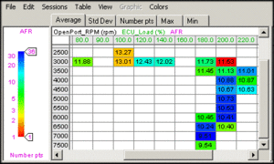

I installed two bungs on my HFC. One for the stock narrow band at the tail of the HFC and one for the wideband on the mouth of the HFC. Today I logged the AFR. Boy is this car running rich stock. This is richer than my 8 was, but I only logged my 8 with a TBE. I never logged it stock. Here are the 4 logs averaged. I suspect that the knock that I was getting up top is due to running rich. You can knock when you run rich.
The car is below 11 starting @ 4000 rpm What the hell was thinking tuning the car like this.

Old May 29, 2007 | 04:49 PM
RazorLab's Avatar
Posts: 14,094
Likes: 1,092
From: Mid-Hudson, NY
I've seen 8's run richer than that.
They were thinking of a way to allow conumer joe to run 89 octane and use timing retard to control knock threashold. Totally impossible with a car tuned with a a powerful AFR and with even less than optimal timing. I bet Car is about 65% undertuned from factory
Does your wideband AFR data represent a completely stock ROM (no mods to lean spool, AFR map or anything else)?
Old May 29, 2007 | 09:48 PM
nj1266's Avatar
Posts: 3,254
Likes: 13
From: USA
Yes. I only have the 2byte load and JDM MAP sensor patch.
Interesting. Seems that with lean spool enabled, the actual AFR runs about 1 point richer than the AFR in the fuel table. Would be interesting to see how close actual AFR is to the AFR table when lean spool is disabled.
Interesting. Seems that with lean spool enabled, the actual AFR runs about 1 point richer than the AFR in the fuel table. I knew that lean spool leans out the AFR by about 1 point, but I wasn't sure how close actual AFR to the AFR in the table. Would be great if you got another log with lean spool disabled.
My before and after log files showed a little more than 1 point richer after where it steadily declined to nothing where it stopped at end of spool . For that log it was from 3500RPM to 4100 rpm . Not sure if it's RPM related or spool (VE, TPS, MAF open/closed loop) related, or both - for I changed the fuel map shortly after
