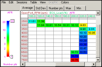

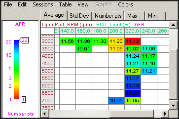

Originally Posted by mrfred
Yep, and 7594 is fine if you want to keep it around 7500. I also suggest that you try setting the disable rpm to 2500. This effectively turns off the lean spool program. Most people find that its easier to control AFR with lean spool turned off like this. And actually, I'd be very interested if you could log some WOT runs with the lean spool start/stop rpm set to 2500. I'd like to see how the AFR compares to your run that you posted at the start of this thread.
I have done something similar on my Evo 8 before I traded it in. I ran it when it was tuned with a TBE and approx 20.xx psi with the lean spool activated and then I deactivated the lean spool. Here are the results:
With lean spool on:
With lean spool OFF:
The AFR becomes about 1 point richer in the low-mid rpms with lean spool disabled.
I was thinking that there would be a richening even at higher rpms because of the IDC jump that I would always see when crossing over the disable rpm.
