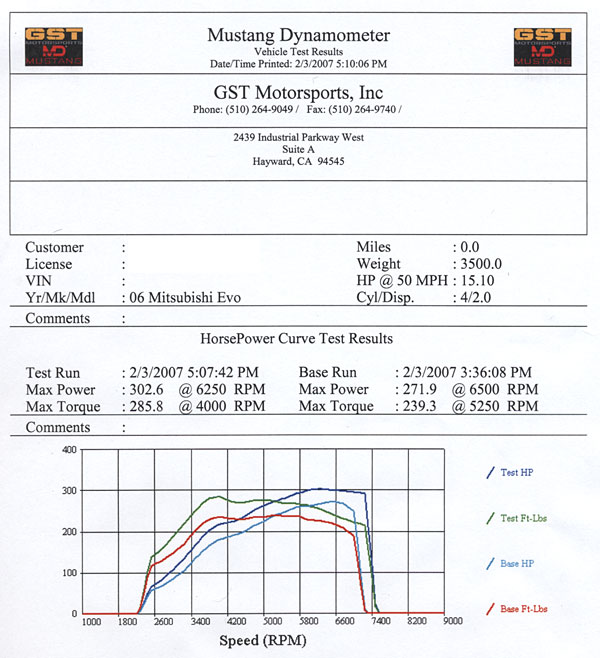

It however can pull timing based on knock and octane level. It can also change boost depending on changing loads (like more airflow from exhaust mods, etc)
The big big gains from evo 9's are tuning the Ignition timing and mivec. It runs very very little from the factory down low. This is why most 9's with turbobacks and stock tunes run way higher HP than TQ.
Add a couple degrees of ign timing at peak torque and around and walla! Instant 40+wtq.
Here is a good example of this, it is also using stock boost control, baseline is stock ECU and test run is after tune. All mods the same before/after.
Good findings however NJ. I also haven't seen the "kill the party" problem on 9's with mods and no tune. However, the peak trq AFR can be a little lean for my comfort on 91 octane fuel with a little more boost. So that is a good thing to get changed with a tune.
