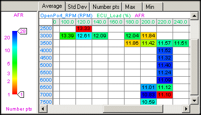

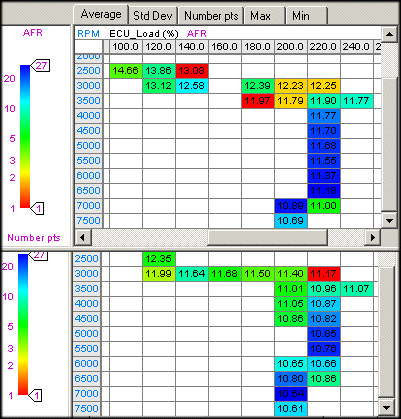

1. As mentioned slapping on the filter w/o tuning makes your car run rich. This happened despite the fact that the car did not hit higher load cells. I checked and double checked for leaks, but I consistently logged a rich mixture with the ebay filter untuned.
Here is a before and after chart. The before are always on top and the after are at the bottom:
So you will have to tune your AFR back to the way you had them before you installed the filter. It took me about two logging sessions to arrive at an AFR chart that somewhat resembles the one before I installed the ebay filter. It is not the same, but it is as close as I could get it to while keeping knock in the 1-2 counts here and there.
Here is the final AFR chart that I used with the ebay filter:

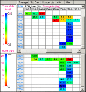

2. The filter also messes up your timing up top. My car lost 1* of timing from 6500-7500 rpm. At first I did not notice, but then I checked and found a consistent loss of timing by 1* up top.
Here is the before and after chart:
I had to go back to the timing tables and adjust them back up by 1* in the affected rows and columns. I was truely surprized by this and I have no explanation as to why the timing got pulled up top despite the lack of change in the load cells that the car hit.

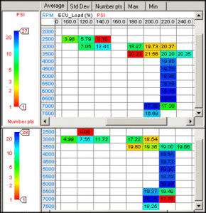

3. I registered a boost increase in the 5500+ rpm by ~1 psi or less. The peak boost was not affected much. Infact it was a bit less, but that could be due to weather conditions even though I tried to keep the variations to a minimum. In the 5500+ rpm the ~1 psi gain was consistent and repeatable.
Here is a before and after chart:

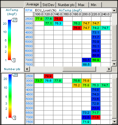

4. The IATs are my biggest concern with this filter. With the stock air box the IATs dropped by an average of 9* F during the WOT run. With the ebay filter the drop was only an average of ~2* F. IMO, that is no good and the filter requires some sort of a shield. BTW, I did keep the snorkel for the stock box while testing the ebay filter

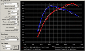

But does the Ebay filter produce any power gain on a lightly modded car like mine? It did produce some gain, but not a lot. I did have one run when I recorded a 16 hp gain over the last run I did w/o a filter, but that was a HERO run and was not replicated in other runs. So I will ignore it.
Below is the best run I had with Logworks before and the best run I had with Logwroks after. I am going to compare results from the same logger to keep things consistent. The gain is 7 hp and most of it is concentrated above 6500 rpm. Are 7 hp worth the increase in the noise and possibly attracting the police. Only the end user can tell.

Why would my car consistently and repeatedly lose 1* of timing from 6500-7500 with this filter?

I lost timing, too, more so in the midrange to upper RPMs. I'm pretty sure that I was at a slightly higher load, though, which would explain that. Unfortuantely, I didn't log 2-byte load.

Here is the Hero run that I talked about in my prior post. It gave me 17 hp over the best run w/o the filter using logworks. If I can get consistent 15-17 hp from this filter, then I will definitely keep it on. Alas, this run was an orphan

Did you happen to log the airflow as 2 byte by chance?
Wondering if timing was adjusted from the raise in temp and baro psi's. I guess with IX's you can be in the same load cells without knock but run less timing with same maps but with interprolation (w/o knock). The VIII FSM claims timing is advanced with elevation, I havent seen this yet though.
BTY - Thats heavey timing at peak if you ask me

No, I did not log the 2 byte airflow. I suspect that the solution to the richer mixture might be in the higher airflow due to the ebay filter. But I am speculating w/o any data to back this up.
The 1* timing pull is the biggest mystery to me. It happened in ALL THREE logging sessions with the filter prior to adjusting it on the last logging session. The timing pull was consistent and replicable.
Timing would be high @ peak if this was an Evo 8 OR if I was running higher than stock boost. Evo 8s usually like 2-3* timing @ peak on 91 pisstane. The 9 can run higher timing on 91 pisstane. If I was running 22 psi of boost, then I dial the timing back to 3-4* @ peak.
