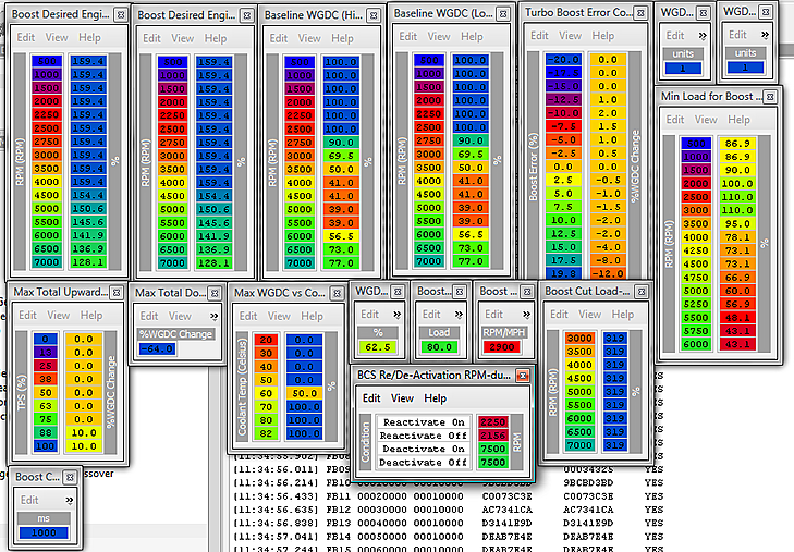

Don't have a 3 bar yet- can't afford it Here is a screen shot of my current settings. What do I need to adjust in order to reduce the amount of error correction and load correction?

Here's a better resolution picture- sorry for the other

I've gotten better at tuning this - I think. I'm hitting and holding 23psi on pump gas until redline with no problem. My logs show that my WGDC is better +-5 through out max, but my load error is still going a little crazy. If load error is positive do you lower the BDEL or raise it? Another question is, if I'm hitting and maintaining my requested boost, how important is it to try to get the load error closest to zero? I've done a pulls back to back and the load error seems kinda inconsistent and I don't want to chase my tail if the car is driving fine.
