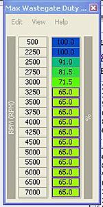

Bryan - I used some values that you posted for WGDC - you said that it had you holding 20.5 psi.
With these values I am only getting ~15 PSI. Could this be an indication of a boost leak does every car take different numbers?
I turned up WGDC 10 units and got an increase in boost off about ~2 psi.
Thanks
Thanks
Which settings did you use, what are your mods and what solenoid and/or pill size?

I have a GM solenoid, no pills.
Turbo Back, IC pipes, Intake, 02 Housing, FMIC.
MAP numbers from ZT2 boost sensor.

I am now using the following map.

Originally Posted by Evo_Kid
What do you have in your BDEL and offset tables?
BDEL is 159, offset is 100.
Error correction is set to 0 across the board.
159 on the whole BDEL table? If you actually had Error Correction on, the ECU would be adding WGDC to try and hit that 259 load as you are barely hitting 240 without error correction on according to your calc Load in that log above at least. It's odd that you can hold 19psi with 65 WGDC all the way down. Usually you need to bring the WGDC up the higher the RPM.
First off, I would get your boost control tables actually dialed in. 159 across in BDEL and flat WGDC is not using Ecu-boost to it's fullest potential.
If you have the means, I would do a boost leak test just to take that out of the equation. Then set up your tables correctly. Should start to look something like this:
Numbers will be different for your application but the 'curves' should look the same.

I am just beginning to tune the GM solenoid. I plan on setting up my BDEL and TBEC later but I have zeroed it out like you suggested in another post.
I have done a boost leak test and I did not find any leaks however I did have air coming out of my valve cover (Due to valve seals I think). There for it was difficult to tell for sure if I had a leak.
I was justing wondering if it is normal to have these values in WGDC for the level of boost, this is by no means my final tune for boost control.
I apologize if I came off like I was saying "Dammit! You are doing it all wrong!" I wasn't sure if you knew so I was just trying to help.
For the stock turbo it's pretty close, maybe a little high. What does 65% WGDC give you PSI wise at 7000 rpm?
Do you have a full pull logged?
