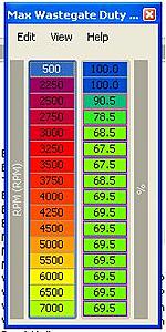

Here is a 3rd gear pull (up a hill)
Code:

Here is my WGDC
Attached Thumbnails HOW TO - Control boost using ECUFLash and 3 port GM boost solenoid-boost.jpg
