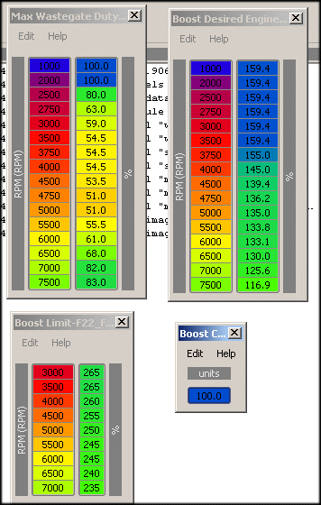

Attached the log and the boost tables. I want to know why is the MWGDC different from the one that is logged? How do I make them the same if possible?
The link to your log didn't work. The simple way to make the WGDC match the baseline WGDC (its not a max WGDC) is to zero out the correction table. I'm guessing that you are looking for a better answer than that though. If you can fix the link to your log, then I can check it out.

I fixed the link. I am talking about MWGDC. It is the table in the ROM that say MWGDC. I want to know why the MWGDC numbers in the ROM are different than the one logged in the log. And I want to know if we can make them the same.

The table in ECUFlash that says MWGDC is not actually max WGDC. The table is mis-labeled (as are a few others). Its really a baseline WGDC that the ECU can move up or down depending on whether the actual load is above/below the target load. How much it gets moved up/down depends on the values you insert into the TBEC correction table.
I plotted your data. The recorded load is matching quite well to the target load. The reason that the WGDC is running below your BWGDC values is because that's what's needed for the load to be at the target load. You can change the values in your BWGDC table to the WGDC values recorded in your run.
I think part of the problem that you're having is that Logworks has this funky thing where it plots the same value many times over. I suspect that this block data is hiding the true shape of the load curve in the lower rpm range.
