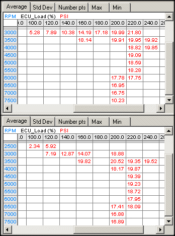

And what are your fuel values in the 220 load column and the 240 load columns?
Do you also have a log of your boost plot from cat to test pipe? Can you overlay them?
The boost is about the same @ ~ 20 psi. Here is the before (top) and after (bottom). There is one data point @ 21.80 in the before, but that is an anamoly.
