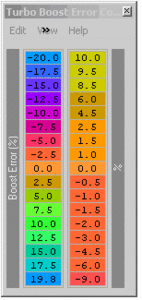

What does your error correction table look like?
Old Oct 6, 2008 | 05:44 AM
  #212
evo828's Avatar
Posts: 195
From: Slovakia
The TBEC is attached. But I do not think it affects the logged MUT 8C as it (8C) should just be showing the "Desired Load" that the ECU is aiming for based on the BDEL+BCLO at the particular RPM. But in my case - it is not

The code to calculate "target load" is pretty simple (although not as simple as it could be). Are you sure that you're logging "target load"?

I hope so - the address (8D25) I have found in dissassembly of 96530006 - that I had from BEZ - and it looked similarly to what you have found in other ROMs. Also it looks very close to the target load - as seen in the first post - chart. I will look into dissassemlby again - but I am slightly lost in the routines

The logged value I am showing in my chart is taken from MUT 8C (8D25) - which should be the target load also based on the dissassmbly references. So I do not know why it doesnot match the BDEL+Offset
