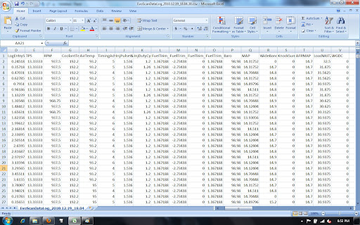

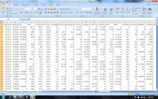

I tried this patch on my car (96940011) and OMG WTF is going on! After a while of just sitting and idling the car starts going up and down on RPMs up to 2.5k and then eventually holds at 2.5-3k. While my wideband reads 18:1! And fuel trims, rpm, TPS, almost everything on my evoscan logs is all over the place.
I was watching evoscan as I drove and idled and it constantly showed fluctuating knock values (0-180ish). After reading the wideband log I now know it wasn't evoscan that was fritzing . Anybody else have this problem? I transferred all my maps as is from my old rom to here.
Here is my normal rom:
Here is the patched rom:
This is what worries me the most. Column R is wideband. When it goes up to 18:1 is when the rpm surge happens.
