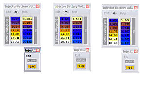

Wondering if anybody has experienced this:
I'm having problems with my car starting when the engine is warm (after sitting for 35-45 minutes). It takes around 4 - 8 seconds of cranking before the car will start. If the car is cold it starts everytime with some sputtering. If I start it immediately after shutting off the engine there is no problem. This weekend I will be testing the fuel injectors I purchased from WORKS (780cc) to make sure they aren't leaking internally. I have tried three different injector latencies with no success (see attached). This problem began occurring after installing the following parts:
780cc injectors
FP green turbo
Walbro 255 hp
ported exhaust/02 housing
3" downpipe
GSC S1 cams
Any ideas or thoughts?

Well, I received a new set of injectors today. After installing them I went out and did a test with the same results. After taking the car for a ride to get it up to normal operating temperature, I shut it off, waited 45 minutes, and then attempted to start it. It cranked over for about 5 - 8 seconds and then started. I'm completely lost as to what the problem might be.
What's even more frustrating is that my brothers stock injectors work perfectly on my car so it has to be the latency/scaling values that are off.
