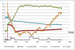

Yeah. We do have 93 oct here. What I want to do is tune the GM 3 Port at 22 and then go to local tuner (we have a few really good tuners here) and get a real tune. But since they usuallly use a MBC or EBC I just want to mess a little with the 3 Port setup so I can e of help during the actual tune if it is required. I was not aware that you can knock due to overly rich condition. Anyway that was not my case. In the meantime I can learn a little about self tunning I have been dealing with cars for a long time (since I was in college 10 yrs ago).
This is the worst log I got on my current setup. This was before instaling the walbro HPFP which I just finish this morning.
