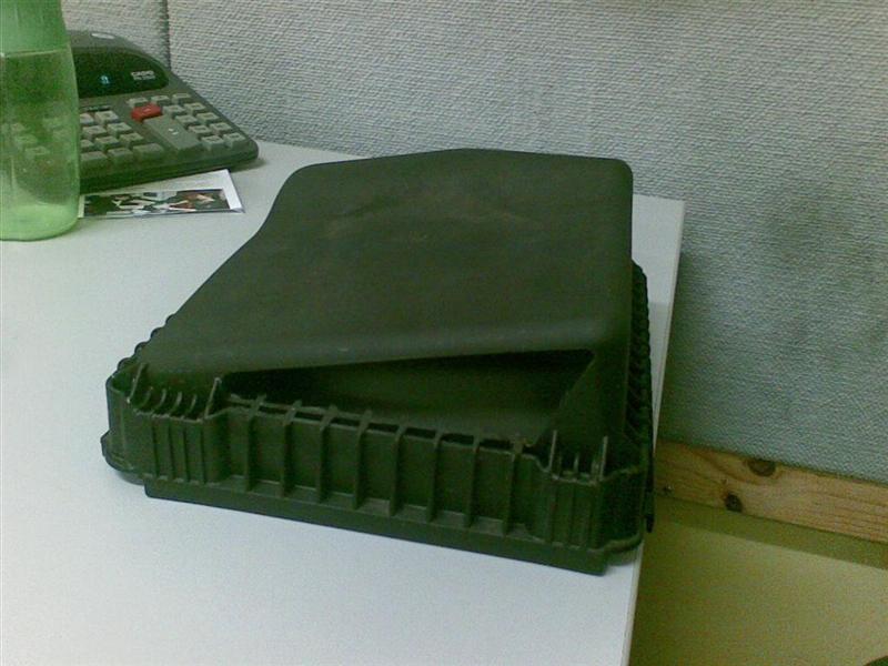

LOL! I'm guessing that friend is me...
And as far as the intake mod, see attached...
Originally Posted by Asmodeus6
If this is about the intake tube itself.
Get new friends...

Thats alot different.
*phew*
thank god!

what did you think I meant?
Old May 30, 2008 | 05:46 AM
  #67
logic's Avatar
Posts: 1,022
From: Berkeley, CA
I think he thought you were referring to the snorkel between the airbox and the turbo.

And yes. I thought he was talking about whacking a hole in the intake tube.
I almost cried.
All good now tho.

Ash - sif im going to put a hole after the filter OR MAF :P hhahaa
